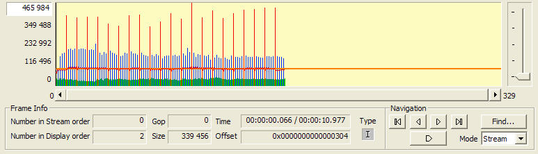

    If you examine your clips in a stream analyzer, you will find the sequence like the following: each I-frame is a keyframe which provides a reference for subsequent frames in the GOP sequence. For AVCHD camcorder structure, this is organized in sections of 15 (for NTSC land) as edDV mentioned. Graphically you can see I frames are red, P are blue and B are green:
    I B B P B B P B B P B B P B B
    All AVCHD camcorder clips will automatically end right before the next I-frame. You can't end anywhere else even if you tried. If you were to example 1000 clips, all 1000 would show a similar sequence. So when you concatenate (append end on end) with tsmuxer, this is lossless and each clip is aligned perfectly before the next I-frame
    edDV was referring to destructive cutting where you make a cut somewhere within that 15-frame sequence, but not at the proper end spot. If this happens, then that GOP structure delineated between subsequent I-frames has to be reconstructed. Since this is re-encoded when it is reconstructed, that section would lose quality. However this is not what you are doing. You are just joining the clips that the camcorder spit out, all perfectly aligned. In fact, even if you used the cut function in tsmuxer, it would skip to the nearest I-frame (i.e. it is not frame accurate), to cut at the proper spot, so you never get this problem
    Again, appending with TSmuxer is lossless, it does not re-encode, and it cannot degrade the quality. If you think you have an example where the quality is somehow deteriorating, please post the samples requested - this is the only way we can help to improve the software if there is a confirmed bug. Also, your camcorder is a newer model, it is possible (although unlikely) the clips are slightly different in structure.
