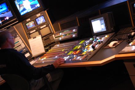

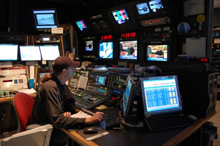

    So for things like newscasts , the station graphics / overlays etc are encoded done in real time? or are they pre-produced before with a slight delay before broadcasts? Obviously these are hardware based solutions for both MPEG2 and AVC in Europe?
    Local broadcast studios usually are live uncompressed with incomng uncompressed graphics and compressed video elements (various formats). All is hardware composited in a device called a production switcher. Welcome to my world.
    http://www.engadgethd.com/2007/08/30/what-it-takes-to-produce-an-hd-newscast/
    The 24x7 on air integration center is called "master control". It is here that local live studios, network feeds, commercial breaks and recorded video server elements (various formats) are live composited in a hardware master control switcher. The uncompressed output is encoded to ATSC MPeg2 and fed to the transmitter. This done for the primary and each subchannel of the ATSC transmitter feed.
