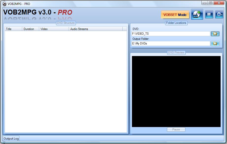

Perhaps the VOBSET mode will work on those DVDs? (Assuming the numerous Titles are in the same TitleSet)

Ok. What you can do it the following:
Copy the original DVD VIDEO_TS folder (so that you have a copy to go back to).
In VOBSET mode what happens is that files from the same Titleset get merged. But this is by file name only. So if you have:
VTS_01_1.VOB
VTS_01_2.VOB
VTS_01_3.VOB
you will get one mpeg containing those files merged.
So in your case if you have:
TitleSet 1:
VTS_01_1.VOB
VTS_01_2.VOB
VTS_01_3.VOB
and
TitleSet 2:
VTS_02_1.VOB
VTS_02_2.VOB
VTS_02_3.VOB
and you want a single mpeg from merging TitleSet 1 & 2, rename TitleSet 2 files so that you have:
VTS_01_1.VOB
VTS_01_2.VOB
VTS_01_3.VOB
VTS_01_4.VOB
VTS_01_5.VOB
VTS_01_6.VOB
Do this to match up what you want. Use something like MPC to view individual .vobs files to aid you. Once you have it renamed appropriately. Run Vob2mpg again in VOBset mode.
If that all makes no sense – post a file listing of the DVD and we can go through it together.SVCD2DVD v2.5, AVI/MPEG/HDTV/AviSynth/h264->DVD, PAL->NTSC conversion.

Seems to work perfectly!
