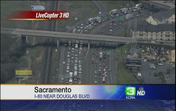

Here's an example when broadcast standard 16:9 tiltle safe is used. Titles are positioned for the worst case which is overscanned 4:3.
Here is the uncropped version. HDTV sets will overscan this about 5-7%
Here is how that looks on an overscanned 4:3 standard TV.
