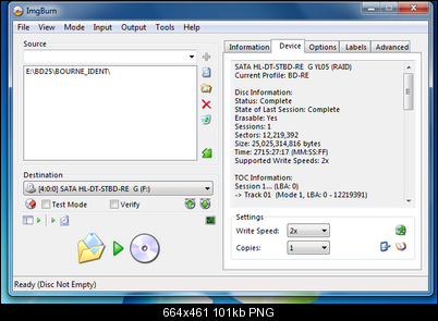

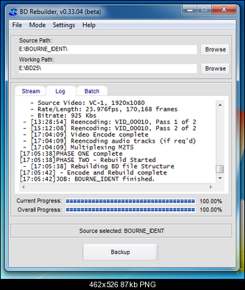

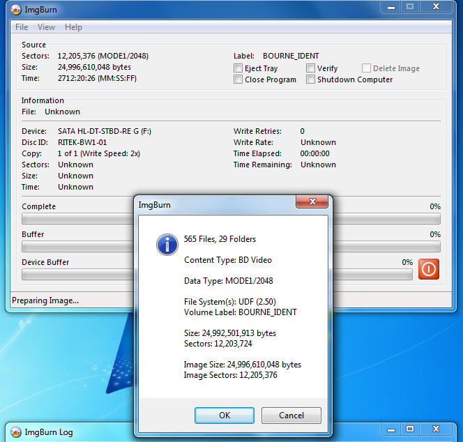

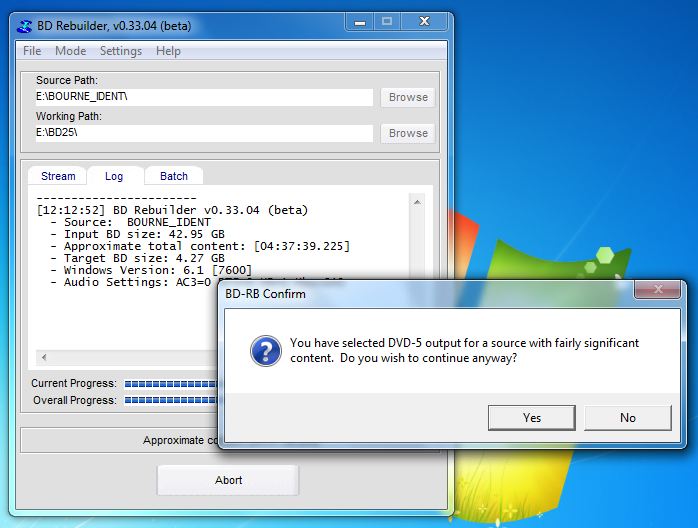

  1. Ok Dewprecious, I have tried Bourne Identity with similar results as you.

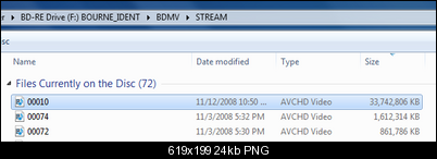

    There is only one m2ts file that is the main movie, so branching is not the problem.

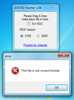

    So, why avchdpatcher is not able to patch the resulting index file is a mystery. Maybe, because the original m2ts file is 32 gb and compress that
    down to 4 gb or 8 gb is just too much. Or maybe because it also has a pip director video track that messes things up.

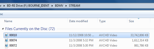

    But doing a back up to BD25 goes smoothly.
    On another note when referring to output setting, please use BD-5 (single layer dvd), BD-9 (double layer dvd) and/or BD-25 (single layer blu ray). Some of your posts have confused me because I didn't understand what output setting you where trying to obtain. Just a friendly comment to make it easier for everyone to understand.

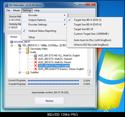

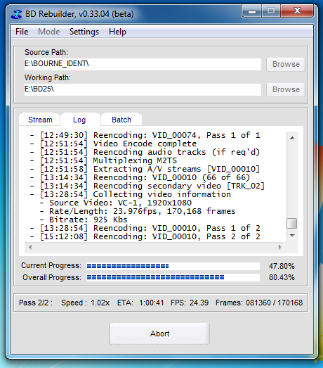

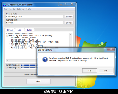

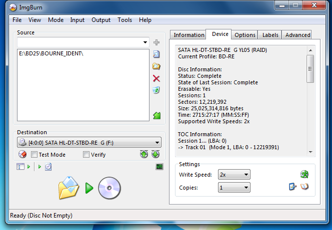

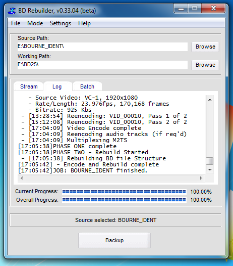

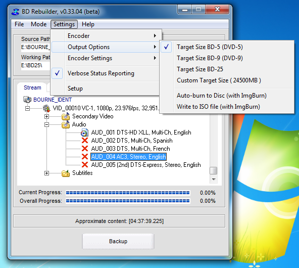

  2. Here is a visual post of how I back up my blu rays. I don't mount any iso images or use daemon tools or any other programs, tools, etc. The only THREE Programs I use are Anydvd, BDRB, and ImgBurn.
Size:  26.6 KBName:  Untitled02.png
Size:  66.0 KBClick image for larger version
    Select Target Size BD-25, or select Custom Target Size ( I normally use 25000 and work backwards until I obtain a 23.2 gb final size--here it is 24500)

  3. Good deal, mrswla. Your example that repeats the error I was receiving, and further info in the post, confirms fritzi93's estimation of probable causes. Your method for backing up to BD-25 (25GB) appears simplified from the guide's method. Thanks for the input. I have been successful in the rebuild from BD-50 to BD-25 using the guide, so yours should serve quite well. I'll give the Bourne Identiy backup a try with this method, although my final goal is to save money by using DVD DL media in place of BD SL media.
    Hey. Don't worry about trampling my feelings with regard to my terminology. I am seriously lacking in that aspect and accept all criticisms happily. What I was using was this: 4.7GB = DVD-5, 8.5GB = DVD-9, 25GB = BD-5, and 50GB = BD-9. Obviously I have been mixing terminologies. My apologies. I should be able to communicate better in the future with the learned correct terms: DVD-Single layer = BD-5, DVD-Double layer = BD-9, BD-Single layer - BD-25, and BD-Double layer = BD-50. (?) Thanks.
    One question. Do you use a DVD writer or a Blu-Ray writer when burning the rebuild data to a DVD-5 or 9? I, again, probably wrong, made an assumption that since the final result could only be played on a Blu-Ray player, the burner to use would be a Blu-Ray. I burned my DVD-9 backup this morning with a regular SONY DVD writer and it seemed to work well.
  4. Yes BD-50 would be BD dual layer media. You may want to try these blu ray discs. I swear by them. Also shop4tech frequently has coupon codes for 15%-20% off, so you could be paying less than $2 per BD25 disc.
    I don't do BD-5 or BD-9, but it should not matter if you use a blu ray burner or a dvd burner. The files are blu ray compliant but you are burning to a dvd so a dvd burner can burn the files just fine.

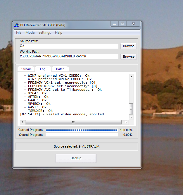

    Hi I am getting this error in BD Builder any help would be greatly appreciated
  14. Originally Posted by Crystara View Post
    [Attachment 1669 - Click to enlarge]
    look like you don't have any input from the source. it only show G\ but there is no path/direction to the movie source on your pc.
