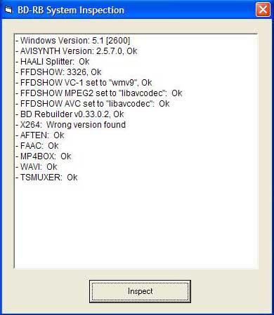

  1. mrswla & fritzi93: Again, Thank you for your assistance and expertise. You folks are amazing and patient. I have followed your advice, once again, installing the correct versions of ffshow and Matroska Splitter, and appear to to 99% ready to have another go at the rebuilding task. I also ran the "inspect.exe" routine and I am attaching a jpeg of the "inspect" result that indicates the "X264" (Don't know what that is) is also in the wrong version. May I inquire for a brief explanation and how to correct this issue? I'm in a steep learning curve here and greatly appreciate any support rendered. FYI: I have many external commitments today, so it will be a bit before I can return to the thread.
    (In case some are puzzled at my ID, it is a combinaton of the pet names shared by my spouse and I)

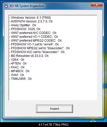

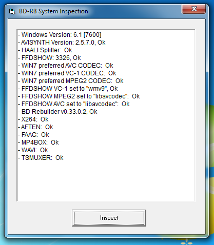

  2. X264 is included in the BDRB download, it's the encoder used by BDRB.
    I'm using the same version of BDRB, and X264 shows as okay. Maybe download BDRB again and run inspect.exe. From the changelog it appears v.3302 of BDRB has a new version of X264 (r1510). But again, it shows as okay for me.
    Pull! Bang! Darn!
  3. Fritzi93, I am running bdrb v3302 and just ran inspect.exe without and error on x264. Weird. What version are you running?
    Dewprecious, trying reinstalling bdrb and see if that clears it up.
  4. Nevermind Fritzi93, I see you edited your post to reflect the version you are using.
  5. Yeah, I double-checked and edited my erroneous post.
    Very weird, dunno what else to suggest than to delete the BDRB folder, and download and set up BDRB again.
    Pull! Bang! Darn!

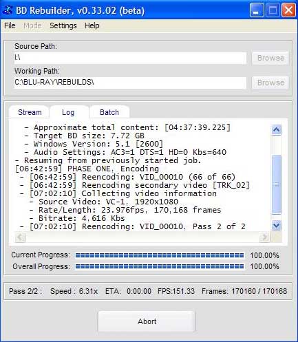

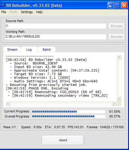

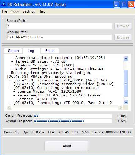

Name:	Phase 1 Pass 2 of 2 in progress.jpg
ID:	1263Click image for larger version
Name:	Phase 1-Pass 2 of 2.jpg
ID:	1261Click image for larger version
Name:	Phase 1-Pass 1 of 2.jpg
  8. DANG! The jpegs aligned in reverse order as intended, but I'm sure you can easily recognize that. My Bad.

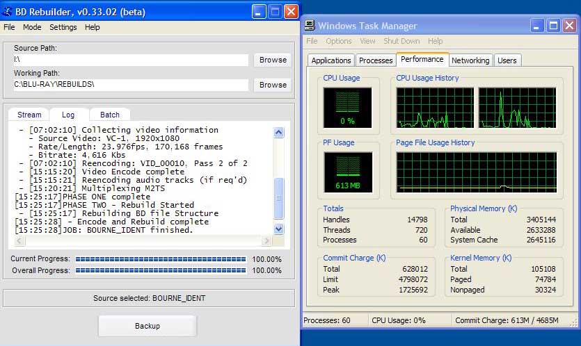

Name:	Job Finished.jpg

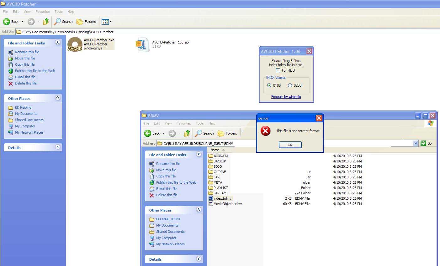

Name:	AVCD Patcher Error.jpg
  12. I'm pretty sure that the setting in BDRB for "Strict AVCHD" does the same thing. At any rate, I don't use that setting or patch the index, with no ill effects. But both my set-top Blu-Ray players are Sony BDP-S360, which are not picky. What's the model of your player? I can probably tell you if your player is finicky.

  13. I'm unconvinced that AVCHDPatcher should *always* be used.
    1) The author of BDRB says: "For almost all players it is not needed. But apparently some Panasonic players need the structure to be more AVCHD and less BD compliant..."
    http://forum.doom9.org/showthread.php?p=1252898#post1252898
    It's not perfectly clear whether the reference is to AVCHDPatcher or more generally is referrring to strict AVCHD compliance. Strict AVCHD compliance in BDRB for movie-only, is Level 4.0, which should be all that one needs to do.
    2) It's unclear whether for some full-disc re-encodes from Blu-Rays with complex BD-J menus, patching may make the disc unplayable. Also some Panasonic and Magnavox players may not like patched discs:
    http://forum.doom9.org/showthread.php?p=1236835#post1236835
    Mind you, I dunno and haven't found a definitive answer. I just do what works on my own players.
