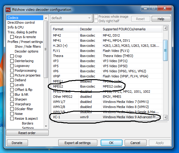

  4. @mrswla:
    You're running Win7. Could you tell us what you had to do to properly configure ffdshow and Haali? Did you need to use PreferredFilterTweaker? It's my understanding that it's not possible otherwise to change filter merit in Win7 without it.
    Thanks.
    Pull! Bang! Darn!
  5. thanks mrswla but sometime I have a problem with the copy movie only mode. It chose the director comment part instead of the main movie. Is there a way to eliminate that.
  6. @ fritzi93:
    No I did not use PFT. I ran setup on both and left everything on default. I don't even know what a filter merit is??

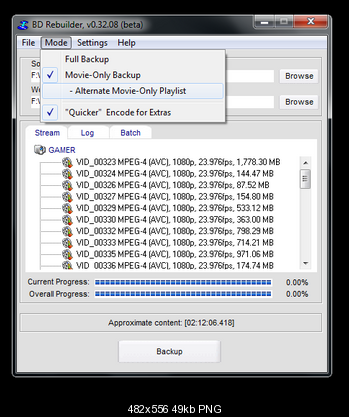

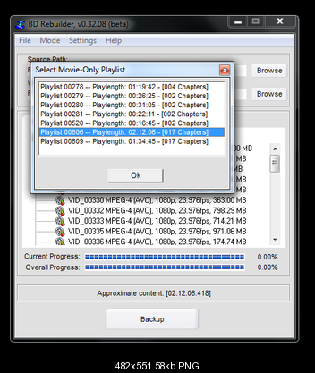

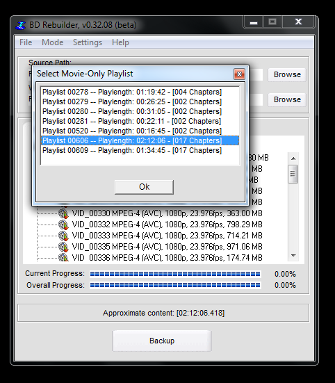

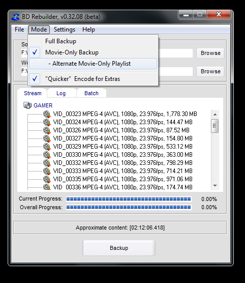

    @ ycnibrc:
    When you select main movie, go under Mode and Select Alternate Movie-Only Playlist.
    Select the title that is the main movie.

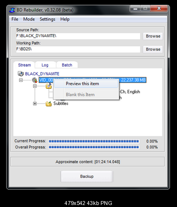

    Right click on title and select "preview this item" to make sure it is the main movie and not director stuff.

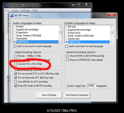

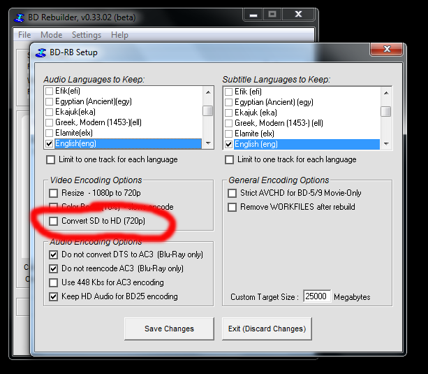

  15. is there a way to convert regular dvd 5 picture to hidef quality such as 720p or 1080p. I watch my reg dvd on my computer and the upscale function did a great job on the picture. It's not far off from 1080p blu ray quality.
  16. Never tried Optimum before, so really can't comment on it.
    As far as converting SD to HD, you can in bdrb but only if it is part of the blu ray disc.

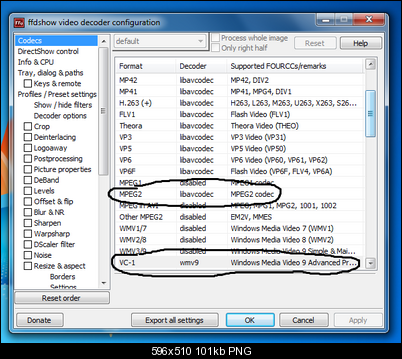

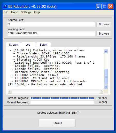

  21. Dewprecious, you shouldn't be using ffdshow rev. 3342. You should be using ffdshow rev. 3326. Uninstall and reinstall the right one first. Then go to ffdshow and open video decoder configuration. Make sure libavcodec is selected for mpeg2 and wmv9 is selected for vc-1.

  22. @ mrswla:
    You beat me to it. Yes, just so.
    BTW, it was only a few days ago that jdobbs changed the recommended version of ffdshow to v.3326.
    @Dewprecious:
    You might want to download this:
    http://www.jdobbs.net/freeware/inspect.exe
    Put it in the BDRB folder and run it. It will tell you if your configuration is correct.
    Good luck and welcome to the forum.
    [EDIT] Using the recommended version of Haali (Matroska Splitter) is important as well. Problems most frequently arise with VC-1 encoded Blu-Ray discs. Get the proper version here:
    http://forum.doom9.org/showthread.php?t=143716
