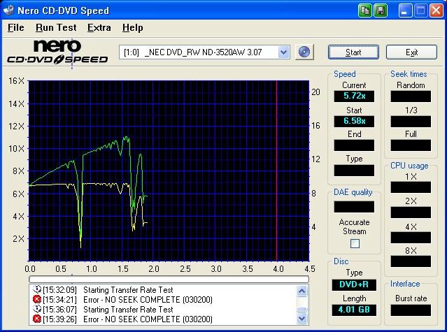

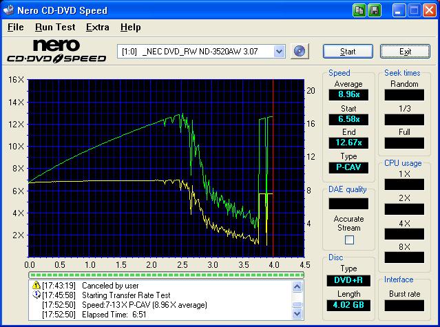

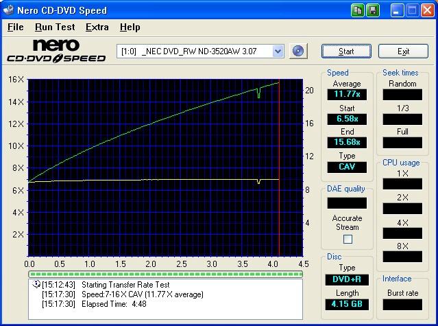

    Try running Nero's CD-DVD Speed's Transfer Rate Test. You want a smooth graph from start to end:
    With poor media the graph will get rough but the test will complete and you will still be able to read all data from the disc.
    Really bad media won't even be able to finish the test and you won't be able to successfully read all data off the disc.

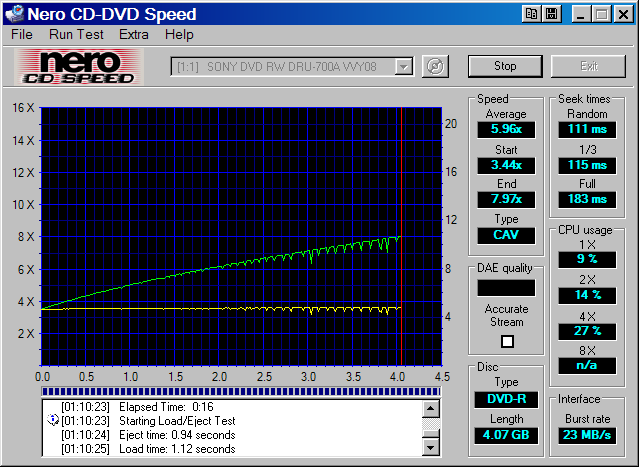

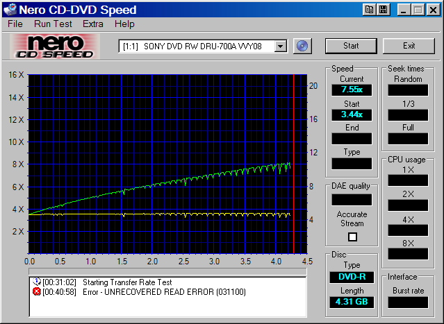

  29. Here is the image for the disc that was burnt up until the end.
    notice that it worked pretty well all up until the end.

  30. I was going to post the "good" disc test results, however, the thing finished just fine, and the graph was "erased"
    Did another testing of the same good disk. Notice how it finished. I guess I need to go back through all of those and see if I need to re-capture them or not.
    It's possible I could simply copy the file over (assuming it copies over successfully) to my hard drive and then re-encode the video, and drop it onto a new disc.
