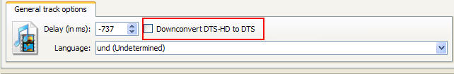

    Tell me how i downconvert with tsmuxer 1.10.6 the truehd or dts-hd to dts.
    because when i check into dts-hd or truehd sound it brind me only the choice "downconvert truehd to ac3" and nothing else.
    Here one picture of it.
  17. Originally Posted by fits79
    That's thd, not dts-hd . It only converts thd to ac3. You can only extract the dts core from dts-hd.
    For every other hd audio type, you have to encode it to dts e.g. using eac3to + surcode
    Here is an example from dts-hd
    You will get the choice to downconvert DTS-HD to DTS when you load a movie into the program w/ DTS-HD bro'
    DTS HD is core DTS + extra info, TsMuxer just strips away the extra info turning it into DTS
    True HD is core ac3 + extra info, TsMuxer just strips away the extra info turning it into ac3
