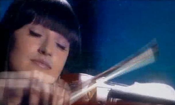

    Please find the posted image examples.

    What you are seeing in interlacing. Assuming you did not resize or re-encode in DVD flick (and I don't know why you are using DVD Flick when you have compliant material) then this will be fine on your TV. If it does not then either DVD Flick or, more likely, Nero, has screwed the field order or done something else horrible to it. When you output from Nero does it re-encode the video at all ? What format does it output to ?
    I would suggest that instead of DVD Flick, you use DVD Styler or GUIForDVDAuthor to author your material into a DVD structure ready for burning. DVD Flick is not the right tool for this job.

    DVD Flick, under 'Project Settings' > 'Video' > ' Advanced' > 'Copy MPEG-2 Streams', that if checked, ensures that a compliant source does not get encoded.

    Thank you. Checking the DVD Flick option 'Project Settings' > 'Video' > ' Advanced' > 'Copy MPEG-2 Streams' helped.
