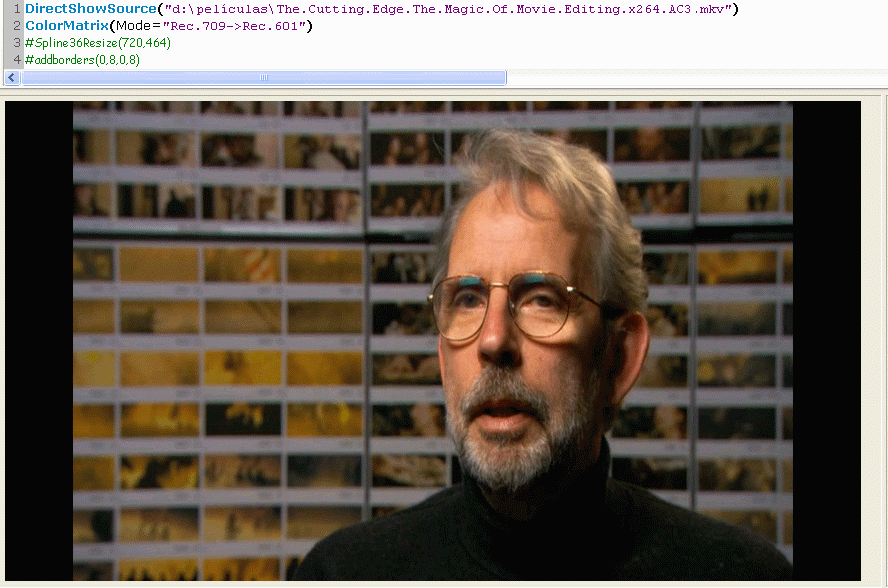

OK. I captured six images from the file: three with directshowsource and three with avcsource.
The original file was 1826 KBps, 720:480, with aspect ratio roughly around 1.85:1. 23.976. The aspect ratio, in fact, it's not 1.85 and I will take the up and down borders out for the final conversion. I think I don't need them and are cutting things away, even if small.
Apparently I have to feed just one image at the time, right? So here goes the first image, entered in AvsP with directshowsource.
You could see the right and left borders, right?

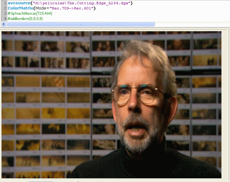

Now look at the same mkv file, now demuxed to h264 video and using AVCsource.
As you can see, I did not cut anything. Only loaded differently.
Why is that happening I don't know. The Matroskasplitter is the latest version.

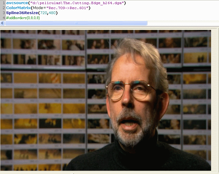

This the final script I will be using:
In the last image the frame is 720x480 with a 16:9 DAR image. All you have to do is tell the encoder your source is 16:9 and encode 16:9. The player will stretch the video during playback.
Something does appear to have added pillarbox bars to your earlier DirectShowSource() sample. When using DirectShowSource() you are at the mercy of whatever DirectShow file readers, file splitters, and decoders you have installed. It looks like one of them is screwing up. You could use GraphStudio to examine what DS filters are in use when DS opens your file. -
HcEnc doesn't do any resizing (and it doesn't need to, as you already have 720x480 16:9 video, which is 100% spec compliant with dvd). Leave it as is, I don't understand why you're trying to complicate your life when what you have is already ok. Besides, you sure you need the colormatrix line? SD video *should* be 601 colorimetry already.
PS the black borders in your directshow image can be caused by anything, i.e. you're depending on the ds filterchain to deliver the pictures and if you don't know exactly what's doing what, you could end up with sub-optimal quality. (Most likely you have ffdshow resizing and pillarboxing to fill the screen resolution or something like that)Sorry, I had to go see about a girl -
