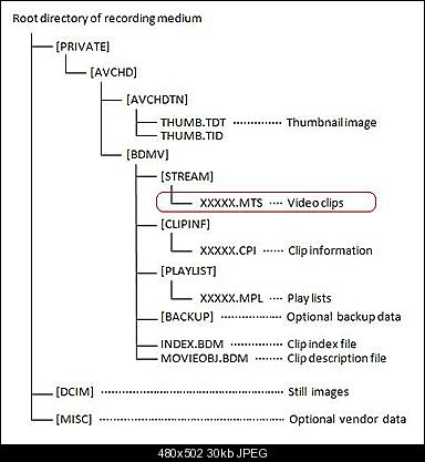

    See? minidv and poison both gave conflicting statements on where that metadata is stored: the .CPI or the .MPL. And it may very well be possible that you need both side-by-side to extract all your metadata, or preserve the entire AVCHD folder structure, or some combination of the above ... we need to know exactly what's going on. We need to know what to extract from the camera and preserve for the future, when hopefully players will be able to stream the metadata back with the .MTS.
  11. here's what the file structure looks like.

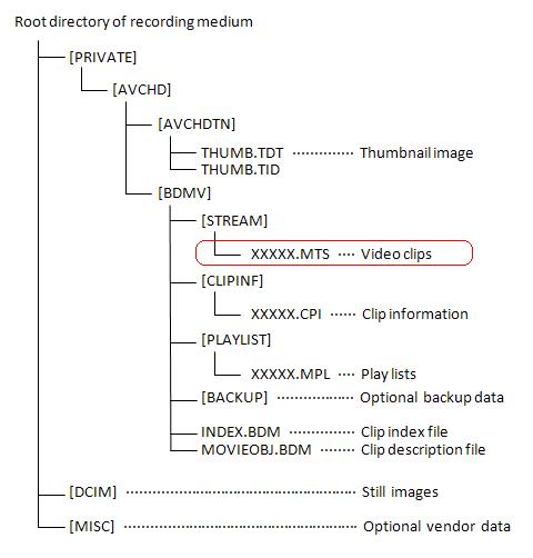

  20. Ok I have a Panasonic DMC-TS3 and it uses AVCHD to save video. I have been looking for an alternative getting the meta data out of the videos files for a while now.
    I finally decided to just try reverse engineering the files myself and I am planning on posting my finding here. So far I have found that the structure if the AVCHD is not very much unlike the Blu-ray standard.
    Here if the structure also posted above:
    I first used Photofun studio which came with the camera to see what meta data I could get out of it. Things like GPS altitude etc. Using this I was able to search for the same values in the files on the SD card using a HEX editor.
