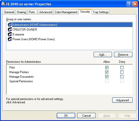

It is most likely to be in the permissions screen on the PC that the printer is installed on:
Here's mine:
You need to provide permissions to the appropriate group of users - if it is only a small home LAN then I would give the Everyone group all permissions.If in doubt, Google it. -
