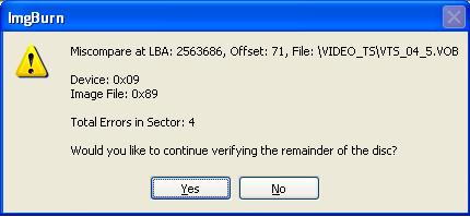

    Voila. I just had my first successful dual layer dvd burn. Firmware upgrade + Imgburn did it. I don't know if it was one or the other or both but the burn process completely successfully. Many many thanks to all those who helped me here. I don't have words to thank you guys enough for helping me achieve this. So, now I have 2 of the pack of 10 Memorex left and hopefully those will work as well when I do need to burn a DL DVD. One thing is for sure that my next buy of DL discs is going to Verbatim.
    There was one quirk though and may be the Gurus here can figure that out as well. The burn process completed successfully but I had the Verify option checked at start and I got some error in the Verify process. Here is the error:
    At the end of verify, I got the message that the Burn Process complete successfully. I have tried the DVD in my Player and it works perfectly. I really don't know why it encountered error in the Verify. If someone can enlighten me this one.
    Thanks a million again......
    Thanks.
    Subhash

    If it plays back properly, I wouldn't worry about the verify. You could run the disc through Nero DiscSpeed and see how the burn went. Probably much better info than the 'verify'. Most likely it's a disc related problem anyway.

    Subhash,
    That's ImgBurn's way of telling you that 4 bytes of the 2,048 bytes in sector number 2,563,686 of the user data area of the disk are not identical to the corresponding bytes in the source material (what was being written to the disk). In other words, 4 bytes on the disk contain the wrong values. While that does technically constitute a write error, it's not something you would likely be able to see when playing back the movie (which is where the errors are).
    If you had been writing critical binary data, the disk would be a coaster, but for a dvd-video disk, it's unlikely to be a problem...unless the disk is meant to be a master copy.
    An additional consideration is those 4 reported byte errors are the equivalent of the tip of the iceberg. They were uncorrectable because the error correction in that ECC block (of 16 data sectors) had already been used up correcting other errors. As a result, that ECC block (and very likely others, as well) will be less able to deal with scratches, fingerprints, etc.
    It would probably be a good idea to mention that I have a much lower (as in "zero") tolerance of errors in digital data than several others on this board. Dvd-video (by its' nature) is quite forgiving of minor data errors, and life (by its' nature) is imperfect, so I can understand the difference of opinions concerning whether undetectable errors are, or aren't, realistically a problem. With only 2 of the memorex disks left, hopefully it's a philosophical question you don't really have to deal with.
    I neglected to mention one other tactic that might help in your circumstance...if you were to slow the burn down (from 2.4x to 1x), it might give you better results.
    Congratulations on your "first successful dual layer dvd burn".

    Vegasbud. Thanks again for clearing this up for me. I am relieved to learn that for DVD-Video this will not be an issue. I will also take your advice that in future I will slow down the Burner speed to 1X, particularly when burning binary data. I for one, just like you, have very little tolerance for errors. The disk I burned will in fact be my Master Copy but 4 bytes of error out of 8GB I will not worry much about.
    Thank you very very much again. Your input and advice has been really very detailed and helpful. Really appreciate.
