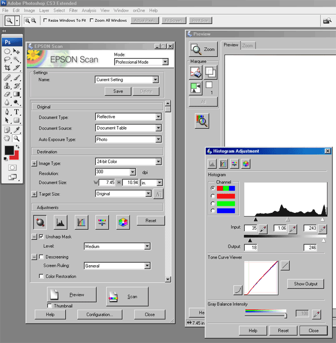

    lordsmurf -- based on your recommendation, I'm seriously considering getting the Epson V300 for scanning about a hundred old slides.
    A couple of questions:
    1. You said "The TWAIN has the embedded corrective tools" -- does the Epson software include a histogram to adjust shadows and highlights for proper exposure before scanning?
    2. Is the difference between the V300 and the V500 that the V500 has higher resolution (not useful for slides, I understand) and comes with PhotoShop Elements?
  13. Video Restorer lordsmurf's Avatar
    Does this answer your question? 8)
