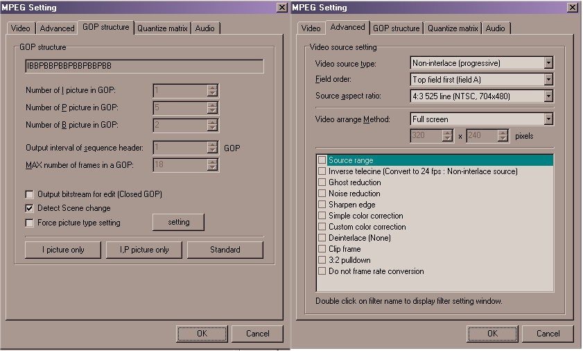

    My suspicions are falling on the Tmpgenc settings. In advanced settings there are checkboxes for Inverse Telecine and 3:2 pulldown. I didn't have these selected, I only had Video:Framerate and the Video:Encode Mode set per instructions on the digitalfaq guide.
    Should I have had settings in the Advanced Box set?

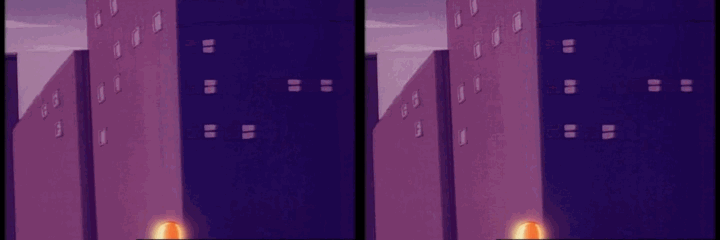

    Here's a comparison of the sample from smurf's guide (left) compared to AviSynth's SRestore() method:
    SRestore() isn't perfect but at least the heaviest ghosting is gone.
    SRestore actually seems to add some ghosting in 1-2 frames.
    Fast pan shots will be problem using any method.

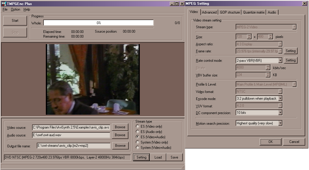

  4. You set the Encode Mode to "3:2 Pulldown Whan Playback" and the Frame Rate to "23.976 fps (internally 29.97 fps)".
    Yes, those settings were called for in the guide, so I've had them set in Tmpgenc all along. But the pulldown doesn't seem to be working.

    Actuallly it didn't. If you look closely you'll see that the two videos start in sync but your video falls a frame behind by the end (watch the siren). In all cases that I saw where it looked like the SRestore() video had more ghosting than yours it was because SRestore() was showing an earlier frame.
    This happened because SRestore() restored the original 24 fps film frames (the PAL version was not sped up, it had duplicate blended fields added and retained the original running time of the 24 fps source). Your technique first created 25 fps and then slowed it down to 24 fps, increasing the running time.

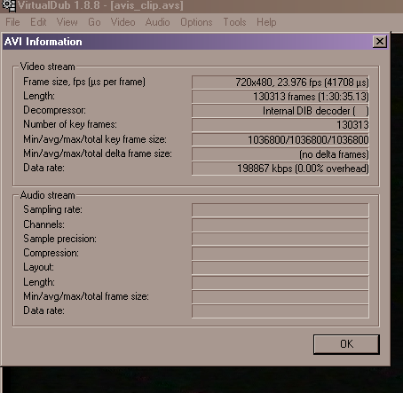

    Open your AviSynth script and VirtualDub and check the frame rate with File -> File Information. It should be 23.976.
    Here that is:
  11. Ok, so the output of AviSynth was correct. It shows the right frame rate and the right running time. Now how about the intermediate AVI file you made (if you still have it). Then a GSpot report on the MPG/VOB file from TMPGEnc.

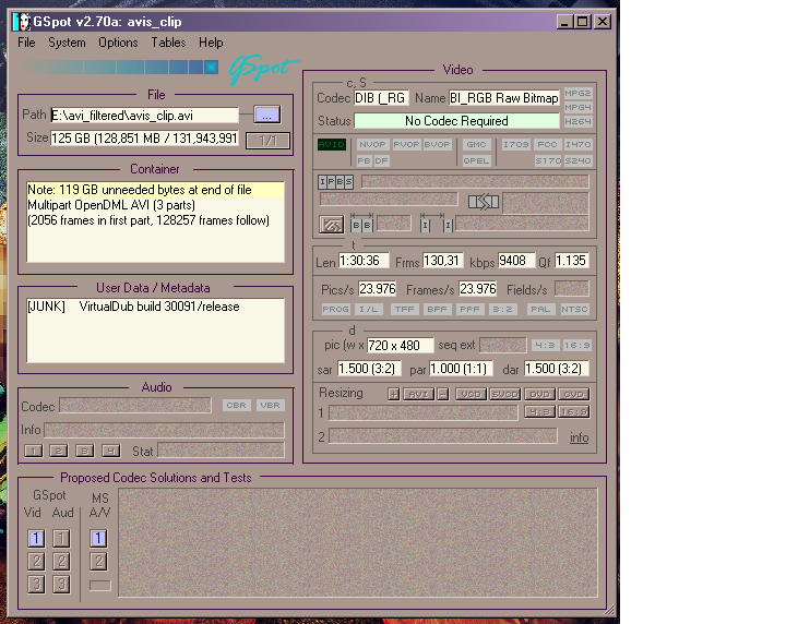

    But the intermediate file I used previously, I still have. Here is the g-spot info on the file I fed into tmpgenc last night through the avisynth script that I gave info on above.
  13. Now, the above report from VirtualDub and G-spot were for the most recent attempt, That went like this:
    Avisynth loads "capture" and filters it.
    Avisynth script loaded into TMPGEnc.
    The previous attempt I made was where I loaded the same avisynth script into Vdub and saved as AVI with full processing. I then put the results of that into TMPGEnc. Here is the G-Spot for that intermediary file:

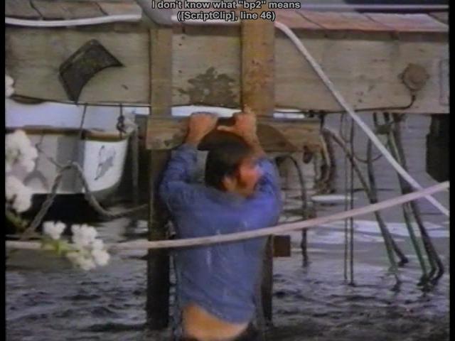

  14. I've decided to work with a smaller video segment to shorten the time it takes to do multiple encodes while trying to resolve this problem. I'm trying to be as thorough as I can in documenting each step. So, I loaded a smaller clip into avisynth and then loaded that into TMPGEnc. (hopefully this is still large enough to make a dvd that will play on my player.)
    Anyway, I am now getting the same imprinted message on the video. It reads:
    "I dont' know what "d32" means
    ([ScriptClip], line19)"

  16. The error it mentions I've traced to Srestore.avsi.
    On the clip it says line 19. In the Srestore script you get a ScriptClip function and on line 19 of that function you get the following:
    17: ## diff value shifting ##
    18: d_v = yplanemax (dclp)+.015625
    19: d43 = jmp ? d32 : d_v
    20: d32 = jmp ? d21 : d_v
    So the first instance of d32 is at line 19. Now, I'm wondering if the program could'nt read this it simply exited out of the function altogether? After all, if it couldn't understand d32 at line 19, it wouldn't understand d32 at line 20 either.
    So, the srestore script was never fully executed to begin with?
    Could this also have been my problem with the read error?

  18. There's nothing wrong with the function. You shouldn't be using SRestore as an autoloading .avsi, but should be loading the .avs into the script. As it clearly says in the included SRestore readme:
    Use import("srestore.avs") in your script...
    Import("C:\Path\To\SRestore.avs")
    In case that's not it (although I suspect it is), the readme also gives you the names and versions of the other needed .dlls. Perhaps you have the wrong version of a needed plugin:

    And below is a pic of the message on the screen. I looked in ScriptClip again and this time the code it had a problem with was a bit further down than before. The first time it was dv32. This time it was bp something. So, again, I can't say that the SRestore had even been used, because I'm not sure what happens when tmpgenc can't read the code. Anyway, I made a disc out of what I had and again, it wouldn't play on my settop, but in the computer the video was way ahead of the audio again.
    I did keep track of every step, so I'm going to go ahead and post everything to see if anyone has any idea. This will take multiple posts because I don't know how to upload multiple pics with one post.
    Here is that message that appears on the screen:

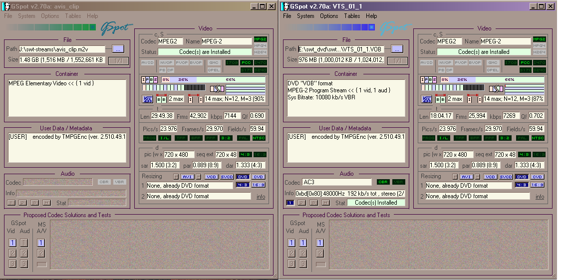

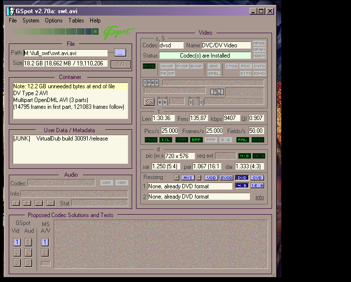

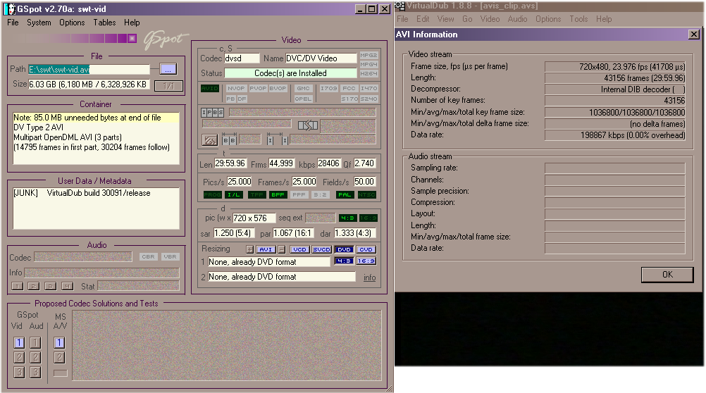

    The following pic had the gspot info on my source file -- the capture stitched together in vdub(that's why it says vdub junk), and to the right of that is the file info from my script in Vdub.
  25. On the left is a gspont of my m2v file, and on the right is a gspot of the vob.

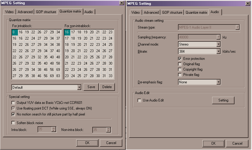

  26. The folowing captures are all of the tsunami settings:
  27. The second and third pages of the settings:
  28. fourth and fifth settings:

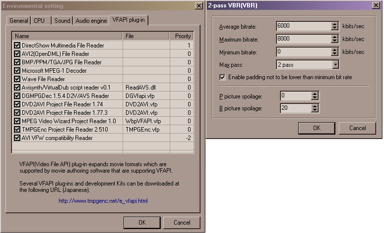

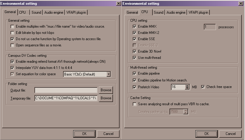

  29. The environment settings that deviate from the defaults:
  30. Finally the VFAPI settings and the VBR setting:
