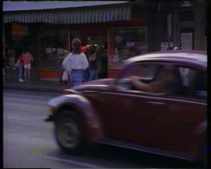

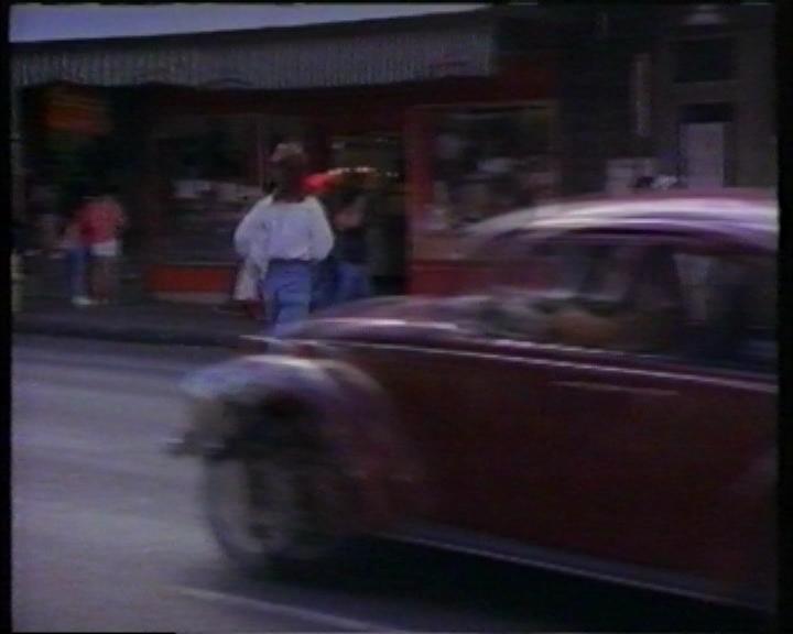

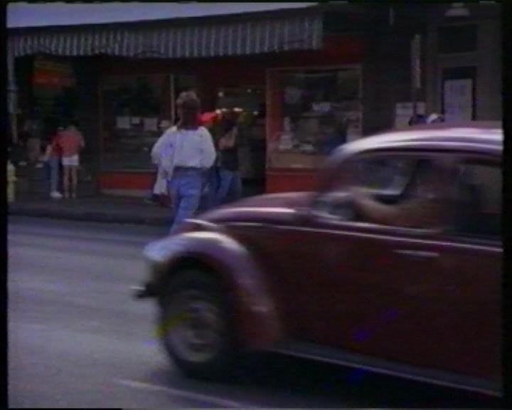

It's badly converted from NTSC to PAL and is field-blended garbage. The 'true' framerate is already 23.976fps after being unblended and the duplicate fields/frames removed. Only AviSynth can do it properly. Here's the script I used:
AVISource("E:\Test\Clip.avi",false)
Yadif(Mode=1,Order=0)
SRestore()
Crop(12,4,-12,0)
Lanczosresize(512,384)
Of course, if for DVD you wouldn't resize, although you'd probably want to remove the uneven and ugly black on the 3 sides and put on fresh black pillarbars on 2 sides. I made a 4.5 MB 512x384 XviD of it that you can find here:
http://www.mediafire.com/?dmznfz2myr2
http://avisynth.org/mediawiki/Srestore
Edit: Loking at the AVI again, I now notice garbage along the bottom. Before resizing I'd crop:
Crop(14,4,-14,-4) -

When I first took a look it seemed to be a movie. Movies aren't interlaced. I then separated the fields and saw the blending, indicative of a crummy NTSC2PAL conversion. The rest was easy - put on the Yadif/Srestore combo.But you didn't tell me what you used to analyze it that you could come to that conclusion.
Yes, Yadif is being used as a 'smart bobber' there. The thing with these field-blended videos is that one of the 2 fields making up the frame is blended and the other is "clean". The SRestore part of that combo then dumps any blended fields and uses the good field as the replacement. It also removes the duplicate frames after the unblending is done. The results won't be perfect. It might not remove all the blending. Because it's using a lot of bobbed fields, in places where there are fine lines you might see aliasing or 'line jitter'. That can mostly be fixed by using better bobbers, but the tradeoff is time - it'll take a very long time to complete the encoding. Yadif is often considered the best fast deinterlacer/bobber. With any luck the end result will be a smooth playing and "cleaner" video.The yadif arguments call for doubling the framerate. I've really tried to understand how you can do this and still have a framerate of 23.976. -

By forcing another fourcc you've changed what DV decoder is being used. I suspect you have Panasonic DV codec installed because it only produces RGB output which Yadif() will not like. If that's the case, get rid of Panasonic DV Codec. It has many problems. Use Cedocida instead.Originally Posted by StrobeLightEpileptic
An easy way to look at each field is to use the Bob Doubler filter in VirtualDub. This splits each frame into the individual fields (quickly filling the missing scan lines with data interpolated from the scan lines above and below, ie, a simple bob) and shows them to you one field at a time in the output window.Originally Posted by StrobeLightEpileptic
If you use the Bob Doubler filter you will see that some fields are a weighted blending of the two fields around it. These blended fields look like double exposures:Originally Posted by StrobeLightEpileptic
Field before:
Blended field:
Field after:
This type of field blending is very common with the realtime frame rate conversion hardware that broadcasters use. The only way I know of eliminating these blended fields is with AviSynth, with Yadif().SRestore() being one of the best options currently. There are no VirtualDub or TMPGEnc filters that can do this.
