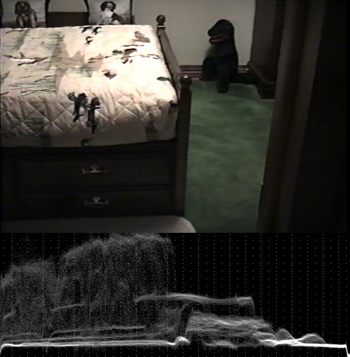

btw, one thing you can fix: the levels are wrong. The ADVC110 expects correct video levels, but most consumer camcorders record "whiter than white". Most TVs will display this too, but PCs will clip it, and certain PC processing will clip it.
You could try this in AVIsynth...
So while the duvet and the duck rug look "burnt out" in the typical home video way at present, with that levels adjustment you'll find that they exposure becomes correct and the details return to the "burnt out" areas.Code:avisource("10 second Sample.avi") levels(0,1.0,255,10,235,coring=false)

AviSource()
Videoscope()
preview in VirtualDub:
AviSource()
ColorYUV(gain_y=-20)
Videoscope()
Regarding the wavy edges and the need for a TBC: all those wavy edges will eat up bitrate when MPEG encoding. -
