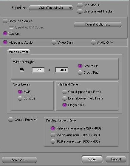

OK, are you working with SD or HD footage?
You can export to MOV
For SD footage;
Export as: QT Movie
custom
.....Format options
.........best for video (slider to far right)
.........48.00 16bit for audio
Video and Audio
720x480
size to fit
RGB
single field
native dimensions
save
Import that file into something like DVDFlick or any other MOV to MPEG2 conversion tool.

I did try to export as MOV file and am wondering what SPECIFICALLY you mean by:
When I open the slide (compression type) there are so many option still to choose. I did choose now as test the DV-PAL (optimal quality), but am not sure if this is the correct one?.........best for video (slider to far right) -

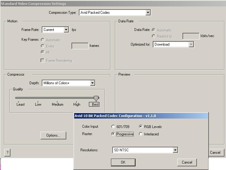

OK, first did you try to import the reference file into AvidDVD? it should also automatically bring in the wav.Originally Posted by B-Twien Bytes
Here's a screenshot, again from an older version, but it should get you going.
Also I'm from the NTSC side of the ocean, so again, you'll have to make that ajustment for screen size 720x576 instead of 720x480.

Does this change the "Avid Packed Codec" option?
Thanks for all your help, appreciated! -
Nope, doesn't change anything....well it shouldn't
Just make your adjustments for PAL.
If your conversion software MOV to MPEG2 doesn't like the file codec, I would go with DV-PAL instead. Then make sure the settings are set to highest quality -
