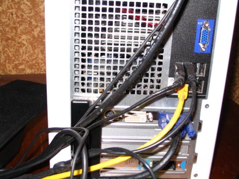

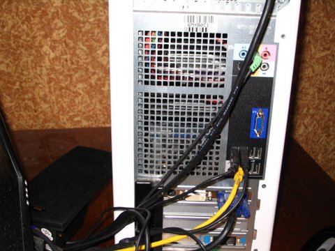

Boy I don't know whether his computer which is a Dell Dimension E520 has AGP ports or PCI-E this is kind of greek to me. Here is the manual: http://support.dell.com/support/edocs/systems/dime520/en/index.htm
My monitor is plugged into a VGA jack next to the DVI and there is another VGA jack upper right in the photo that had a blue cap on it but since it had a cap on it I wasn't sure I could use it or even if running VGA for that long a distance was a smart thing to do.
My son's Plasma will take either a VGA or HDMI cable.
My audio options are covered since he just got an Outlaw RR2150 receiver which has a USB input so he is already running audio from his computer to his receiver with outstanding quality.
So can you tell if his Dell E520 supports PCI-E and what are my options taking into consideration I already ordered a HDMI/DVI cable? Do I need to reorder another cable or look for an inexpensive HDCP compliant video card? -

http://support.dell.com/support/edocs/systems/dime520/en/OM_en/NH730A01.pdf
Look at page 111 of that link.
If you looked through that link you provided you would have seen that your son's HELL pc, oops!
I mean DELL pc has a PCI-EXPRESS 16x video card.

If you don't trust the documentation from that dell link then open up the computer and look to see if it's PCI-E or AGP.
Yes I just read in his manual where it says PCI-EXPRESS 16x video card.
