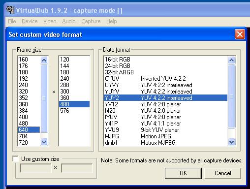

Thanks (especially to jagabo!); I'm running a new capture in YUY2 now. I'm also going to bite the bullet and learn Avisynth (or as much as I can). I've got a couple more things you might be kind enough to clear up for me
1. When capturing via Vdub and my GFX card, I'm getting zero dropped frames but a few hundred inserted frames (using default timing settings) for a 2-hour tape. Audio seems to stay in sync. Is this a bad thing? Would capturing via pass-through/firewire be likely to be better in the long run?
2. I'll be doing a 2-pass encode in HCenc. I assume it is beneficial to keep the number of colour space conversions down. With this in mind, and assuming I want to run some filters (via Avisynth) on some captures:

YUY2 compression method RGB compression method

1. Which options do I choose to capture as YUY2? Which do I choose to capture as RGB?
2. If I choose to capture as RGB how do I know my card isn't first capturing as YUY2 and then converting to RGB? If I choose to capture as YUY2 how do I know my card isn't first capturing as RGB and then converting to YUY2?

just keep it yuy2 and choose predict left for realtime encoding
*** DIGITIZING VHS / ANALOG VIDEOS SINCE 2001**** GEAR: JVC HR-S7700MS, TOSHIBA V733EF AND MORE -
To capture and save as YUY2 set your capture card to capture as YUY2 then in the "YUY compression Method" section pick any of the three options. The fastest one gives the least compression, the "best" one gives the best compression but is slowest. If your computer is fast enough use the "best" option.Originally Posted by Rinsin
If you want to caputure and save as RGB set the capture device to capture as RGB then select the RGB compression method in HuffYUV. The options are similar to the YUY2 options except for the addition of "Convert to YUY2" which converts the RGB data to YUY2 and compresses using whatever YUY2 method is selected.

Thanks for the informative post again jagabo ... one more thing ... how do I "set" my graphics card (ATI Radeon X1900XT) to capture as YUY2 or RGB? I have catalyst control centre installed but I can't find any such option.
I don't know that card but the option is usually set in the capture program. In VirtualDub, when in capture mode, select Video -> Set Custom Format...Originally Posted by Rinsin
