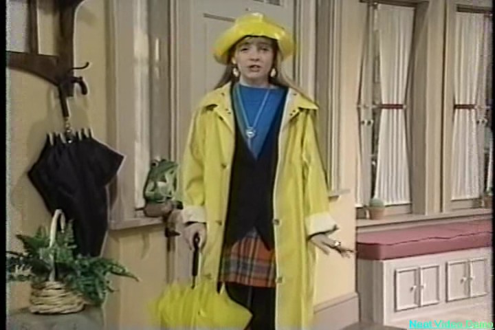

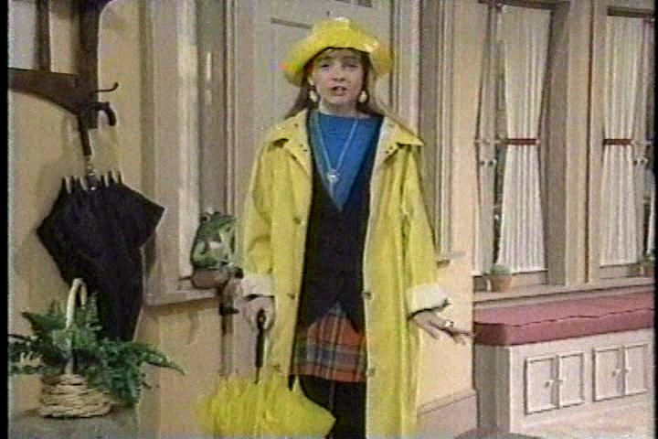

quick Neat Video results: neat.avi
Frame 116 before:
and after Neat Video:
