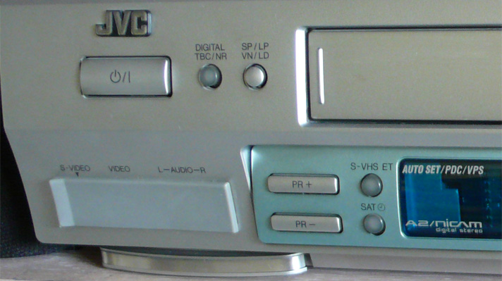

    A guy offered me a JVC HR-S7722, do you know if it's good?
    I think that it has TBC.
    May 2007
    Romania
    I have this model. It is just 7600 with some small desing changes and made around 2001. It perform like every JVC with DigiPure. Lack Video Stabilizer and Dynamic Drum. This features can be found only in the best model made by JVC.
