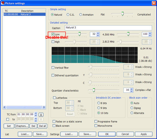

Definitely disable the low pass filter, it substantially degrades the sharpness and should only be used in specific scenarios, (e.g. noisy footage). The specific settings would change depending on the source used. e.g. you might use different settings for indoor concert vs. an outdoor waterfall scene. Just experiment, as there is no hard and fast rule. 16-235 is the proper range. -
Thanks for the quick reply. I am using the currently available version (2.70). I'm not sure what you mean by "disable the low pass filter." Is this related to the quality settings options and/or flat part priority?
No. Only the "Simple Settings" on your screenshot are available in Basic. And one need not even check any of the three options. I'm trying to determine whether the "natural picture" option should be checked. If any of the three options are selected, it disables the ability of the user to manually adjust flat part priority (although the flat part priority will change depending on where the simple/complex slider is set).
