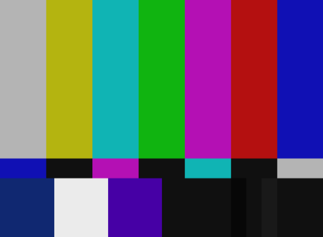

Does the ADVC 110 have the same pattern generator as the other ADVC devices? Capture a bit of that. How does it look?
Some of the ADVC devices have built in pattern generators that will put out a test pattern like this:
How does this file look on your computer?
macbethdv.zip -
The file looks fine on my computer... But how is that testing my ADVC device? I imported it into my capture software programs and it looks good there too.
It isn't testing your ADVC. It's testing how your computer is displaying the video. Many things can effect how video looks on a computer. It sounds like video display on your computer is fine.
