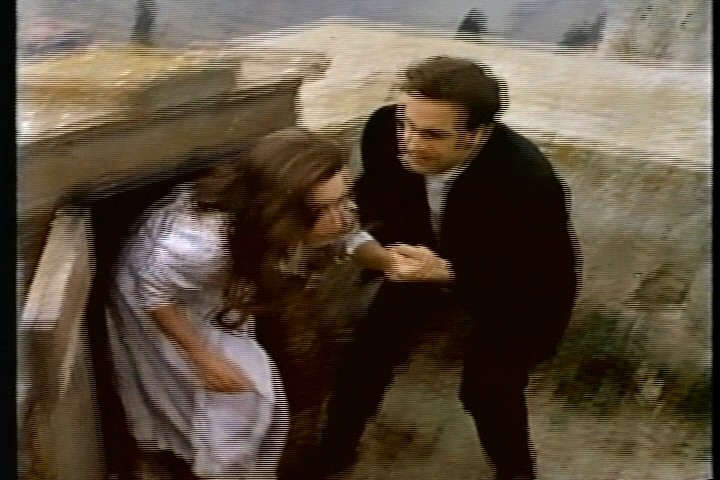

If your lines look something like this:Originally Posted by allthumbs
They will not be fixed by using a cable box or anything external tuner. Standard definition analog broadcast (and cable) is allways interlaced. You are seeing interlace comb artifacts. If you are going to make a DVD just ignore the combing. The DVD player and/or TV will take care of it. If you are making web videos, Divx files, or similar, you will want to inverse telecine or deinterlace to get rid of the comb artifacts. -

this was my first atempt..
before
after
Thanks a Lot, both you guy's, for the help and advice. -
There is something more than just interlacing wrong with the first attempt. The artifacts are gone in the second image but it's not as sharp. What did you do?

Are you aware that the second image is dramatically WORSE than the first?
That the aspect ratio appears to have changed?
That the original problem is something OTHER THAN interlacing?
You can do A LOT better than that second image. You will have to provide some more information if you want help to get there. -

First pic was full-resolution, uncompressed or lightly compressed AVI. There was either some kind of interference, bad signal, or some sort of unGodly de-interlace screw-up.
Second pic apparently on-the-fly MPG, probably VCD-type resolution. Somewhere in here the Aspect ratio underwent a change, or possibly the connection type changed.

In the first sample image there is something wrong with the way the video was encoded or the way it's being decoded. It might be best if you capture a few seconds of video like the first sample image and uploaded the MPG file. Capture with the software that came with the card. -

1. The capture (sample pic) shows what appears to be analog cable interference. This is sometimes referenced as some form of "Herringbone" interference: they can vary in degree or complexity. By the looks of it, it is prob due to using some cheap Amplifier of some sort--I have a GE 4-way distribution amp that does very similar.
2. Take note that based on what I observed, your pic shows a scene from the tv series "comedy central" and this show is all interlaced. That means, (after looking at your 2nd pic below it) your softare capture included a setting for deinterlace, and the is showing it by evidence of the blury/softer look in that pic, followed by some "temporal" noise reduction (NR) feature. The reason I choose "temporal" is because of the way it *removed* the Herringbone noise seen in your 1st pic. Even though we can only see the resolve based on one pic, I would gamble that your (mpeg) capture software blend-deinterlaced on-the-fly that problem content.

It looks like you have some taste for "comedy" shows. These like many others in its class are "interlace" video. They are worse to deal with in terms of converting to a cleaner video, (de-interlacing) unlike content originating from Flim: where you can ivtc the telecined 30i back to 24p, giving you that extra clean I just mentioned.

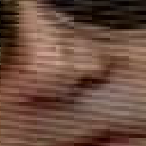

It is much too regular to be analog noise (8x nearest neighbor enlargement around the guys nose):Originally Posted by vhelp
It is some kind of encoding or decoding error. Or way, way, way overcompressed MPEG. -
There it is.. he used "filters" in his capturing or post. Either way, these patterns (as jagabo demonstrated) seem to point to the noisethen i use virtualdub to tweak the video and as for filters i used, after i read the artical jagabo linked me to, it was late and i recoreded a 15 second clip just to get a feel and i don't even remember the filters i used it's still a work in progress at this point.
A closer look did reveal a (noise-induced) pattern. The pattern then reminded me of what I *used* to do in some of my xvid (experimental) encodes to give it that extra sharpness, etc. I knew something was odd about that noise pattern
Removing the *filter* step may help clear up the video and mystery

The way I interpret his post is the "before" image is before any filtering. The "after" image is after filtering. Of course, he also saved as JPG so that complicates matters. Guess we'll have to wait for the OP to reply...
