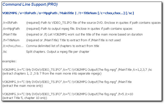

Does the v3 have a command line option yet? If not, is there a roadmap of what is supposed to be in it? Specifically the ability to output to a certain name.
I guess I could always script it after the fact if needed to rename though. -
No. But I will add initial support tomorrow to the PRO version.Originally Posted by casperinmdSVCD2DVD v2.5, AVI/MPEG/HDTV/AviSynth/h264->DVD, PAL->NTSC conversion.

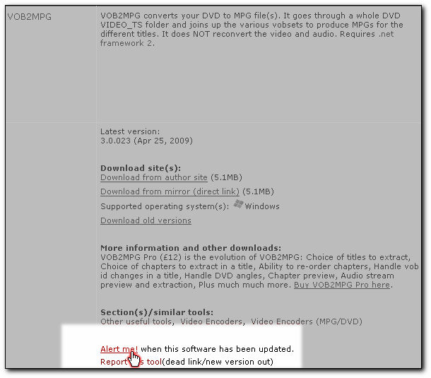

Great just bought it. Do you send out alerts with new versions? Guessing not..I will just check back tonight and again tomorrow. I am excited to test it out!Originally Posted by ChrissyBoy
It is usually announced on the front page here and you can recieve alerts from videohelp:
Here you go:
Code:VOB2MPG 3.0.024 Released 1 Mar 2009 - [PRO] Added initial Command Line Support: VOB2MPG /v=IfoPath /o=MpgPath /MainTitle | /t=TitleNum [/c=chxx,chxx...] [/sc] /v=IfoPath Path to VIDEO_TS.IFO file of the source DVD. Enclose in quotes if path contains spaces /o=MpgPath Path to output mpeg file. Enclose in quotes if path contains spaces /MainTitle Let VOB2MPG work out the title of the main movie based on duration /t=TitleNum Title to extract from if /MainTitle is not used /c=chxx,chxx... Comma delimited list of chapters to extract from title /sc Split chapters. Output a mpeg file per chapter examples: VOB2MPG /v="C:\My DVDs\VIDEO_TS.IFO" /o="C:\VOB2MPG Output\The fog.mpg" /MainTitle /c=1,2,3,7 /sc (extract chapters 1, 2 ,3 & 7 from the main movie into seperate mpegs) VOB2MPG /v="C:\My DVDs\VIDEO_TS.IFO" /o="C:\VOB2MPG Output\The fog.mpg" /MainTitle (extract the main movie only) VOB2MPG /v="C:\My DVDs\VIDEO_TS.IFO" /o="C:\VOB2MPG Output\The fog.mpg" /t=5 /c=10 (extract Title 5 chapter 10 only)
Nice..now before I post my batch file to auto convert DVD's in a large quantity to MPG's...when can I get my hands on the new version :P

Yes sorry. Text updated now.Originally Posted by SWBisbeeSVCD2DVD v2.5, AVI/MPEG/HDTV/AviSynth/h264->DVD, PAL->NTSC conversion.
