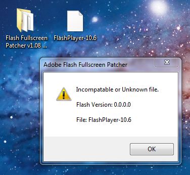

    I'm working on a webcast in Paris and sometimes we need to broadcast some video from the web in fullscreen mode and this stupid message (with no option from adobe to remove it) is painful.
    I'm maybe stupid but your tricks didn't work with us!
    We are on mac, we've done all the process (on Windows 7 via bootcamp) but your program didn't recognize our file "FlashPlayer-10.6".
    We also tried on PC (same version/Windows 7-64 bit) and after your patch Flash is broken/same on mac... We use I'm think the latest version of "flash 11.5.502.110" and "Flash Fullscreen Patcher v1.06".
    Any idea ? Thanks again...

  20. @edonline
    I took a look at your attachment and found the problem.
    There has been a change since I made the instructions.
    < Inaccurate information removed to avoid confusion >
    Question: What is your Mac OS version (10.6?) and is it 64 or 32bit?

  21. @Chronomaster, tks for your answer.
    All our Macs are 64bit on the latest operating system (Mountain Lion 10.8.2), with the latest flash plug-in (version 11.5.502.110).
    The Mac we use for broadcast (on wich we want to remove this stupid watermark) is a Macbook Pro Retina, and I double check what we take:
    FlashPlayer-{Your Mac OS Version}.plugin goto Contents > MacOS
    I make a .zip file to upload here, but the original file we obtain is not an archive (any extension just "FlashPlayer-10.6") or I don't know wich format, I can't enter the file, I didn't see any packet...
    "Strange you said strange"

  22. @edonline
    Sorry about that, when I opened the file in 7zip I thought it was a standard archive.
    The compression reported by 7zip is type: mub
    7zip can only extract from this type.
    After looking at the file header I found the hex 0xCAFEBABE which tells me it is a Java class file or a Mach-O universal object file.
    Next, I found the hex 0xCEFAEDFE that confirms that this is a type of a Mach-O file used by Apple.
    From that information I now know this file is a Fat Binary (Multi-Architecture Binary)
    This may take a while to figure out.
