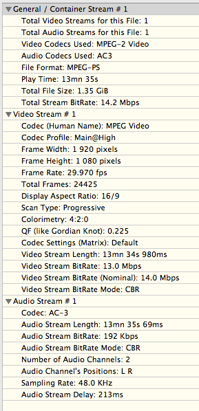

I have a video that when I open up in media info it shows the following data: 1920x1080 16/9
When I play that video in VLC at the default aspect ratio (16:9) - it IS stretched - if I change the aspect ratio to 16:10 I get black bars on both sides and that LOOKS correct. Whats going here?
Results 1 to 8 of 8
If it's 1920x1080, then that's the way it's meant to be played; it doesn't get resized. It has a 1:1 DAR. What kind of a file is it - AVI, MKV, MP4, what? Can you post the Media Info pic?
I'm on OS x but even in QT it displays the same streached image. - yes it is possible that the 16:9 flag was set incorrectly, but how do I know for sure?
Open it in VDub(Mod) or in DGIndex (DGIndex will open it more quickly). If it looks "normal", then it's meant to be 1:1.Originally Posted by tb582
If it does look normal after being opened in DGIndex, and you want to make it so it plays normal all the time without having to reconfigure your player, then first demux it (DGIndex, File->Save Project and Demux Video), run the resulting M2V through ReStream set for 1:1 instead of its current 16:9, and then remux (ImagoMPEG-Muxer). I have no idea which, if any, of these tools work on Macs.
