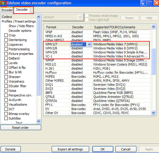

  10. #10
    Video Restorer lordsmurf's Avatar
    Posts
    30,820
    Quote Originally Posted by gadgetguy

    Quote Originally Posted by toqi786
    When I import a wmv file format, even after extracting the plugin pack, it say's missing codec
    Direct import doesn't work for all types of wmv. Post the information from gspot or mediainfo on your wmv
    You need a vfw decoder to use in vdub for wmv. You can use ffdshow and enable wmv 1/2/3 , vc-1 in the vfw decoder configuration (set to libavcodec instead of disabled)
    Or even better , you can use avisynth's DirectShowSource(), and Crop() , this way you avoid colorspace conversions through vdub if you use fast recompress mode - this might be more difficult if you're not familiar with avisynth

    Quote Originally Posted by poisondeathray
    can u explain what i need to do, will i be able to use this in vdub??
    I thought I just did...
    Install ffdshow, enable the following wmv settings in the ffdshow vfw configuration (gold icon), set to libavcodec instead of disabled
    Install the vdub wmv plugin
    If it doesn't work you, may be using wma pro or another type, then post the screenshot taken from gspot or the mediainfo information, because it doesn't work for all "wmv" types, and you would then have to use another method as already suggested
