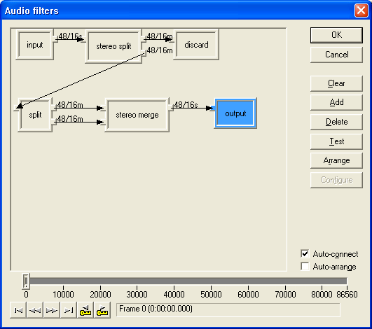

Or for dual mono (same sound on right and left):
Code:Input Stereo Split Discard Split Stereo Merge Output
