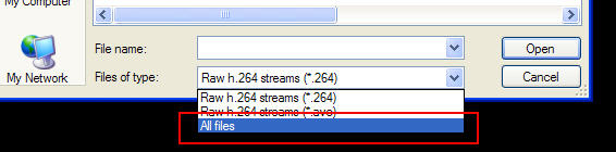

You can use the drop down menu in avc2avi "*.*" to accept "all" streams, or rename the extension manually to .264 -

I don't understand the command "*.*", for the dropdown menu and where to use it (do you mean through the command prompt or the GUI? - I'm guessing the former) I attempted to use it in place of the -h command but no luck.

for avc2avi, you change the extension of the demuxed raw avc (from mkvextract) input to .264 not .h264 ; or use the drop down menu in the gui open dialog box to select all file types
