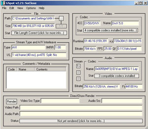

GSpot tells me the video codec is DX50/DIVX (Divx5.0)

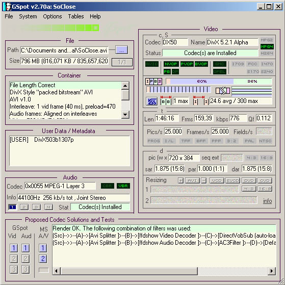

Post a GSpot snapshot of the file.

I'll do a snapshot of the G-spot info & post it very soon ... Thanks for your help! -
OK, we know now it's not simply a matter of DX50 not working. It may be a version number incompatibility. Someone may have used a buggy version of Xvid or ffdshow and specified the DX50 fourcc. Can you open and view the file in VirtualDub or Divx Player?
