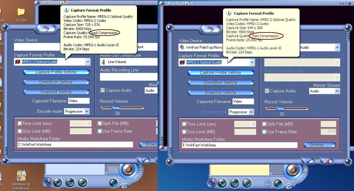

i am using winfast palmtop usb capture device. it was working properly until i formatted my laptop and reinstalled the driver and application (winfast pvr). now, it dose not support available capture profiles (except wmv) i.e. recording in poor quality and without any compression ( for example in mpeg2 optimal quality, instead of good compression, use fast compression) . i test it on my pc and there is no such problem. so there will be no problem with the unit. is this because of some missing software or driver? please help............

hi thanks for your attentionOriginally Posted by Starman*
i have installed all possible codecs before installing it's driver but the problem persists. i am also confused. befor i attached the device, all codecs properties are fine but when it is connected to usb port, all codecs go to their lowest quality and if adjust them manually, hanged up and closed.

It looks like the PVR is adjusting the video quality, perhaps to suit the video rate it thinks the hardware is capable of. Could be a USB problem. I can't help there.
I see that in the two pics, the drive the PVR is using are C and E. The audio settings are missing in the second pic. Probably irrelevant but I thought I'd mention it.
