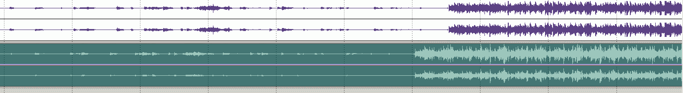

the problem now, nothing match at all.
Before It match at the begin but not anymore, nothing match anymore at all
as you can see in the begin I have match the first pitch in the sound but the other dont fallow

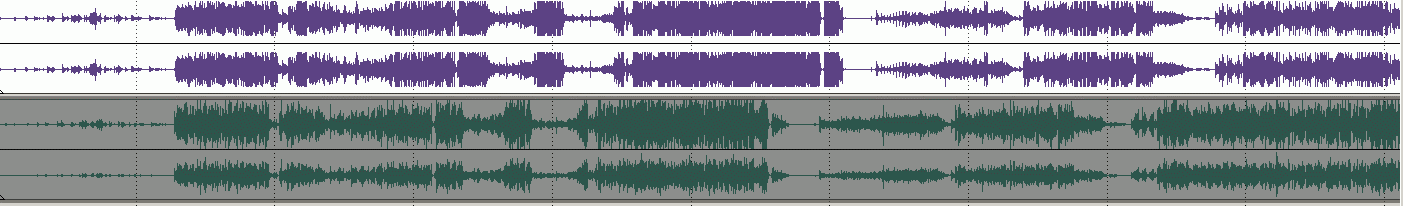

but as you can see in the pic I have begin when both track show high pitch but after that it not in sync.
I maybe have to split every scen from the video and even the audiotrack into piece.
Is going to be alot of work but if I have to do it I do it.
Next time I going to change the Hz and that so it is same as the camcorder.
Okay, your second timeline clarifies what you mean. I have no idea why that occurred, other than something might have happened when converting to 48000Hz, 16-bit.
I have the Zoom H4, and have never encountered the types of problems you have.
Your next option is to go back to Audacity and experiment with tempo changes until the Zoom audio comes more closely to the timing of the AVI.
Do you have VirtualDub? It will enable you to extract an audio wave out of the AVI file to serve as a timing reference. (Just do a short clip no longer than 2 minutes.) Put that reference in Audacity; then under Project > Import Audio, open the Zoom audio and trim it to match the 2-minute reference wav from the AVI. By looking at the 2 audio tracks, you can alter the timing of the Zoom audio under Effect > Change Tempo in Audacity. You'll have to experiment with percentages until you get the timing right. (Make sure you do NOT change the pitch.) Once you find the best setting, apply it to the entire Zoom audio file and export it as a new wav (48000Hz, 16-bit, etc.).
