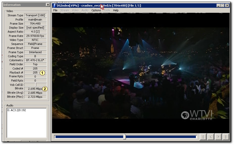

	Ok. How about doing this, to put this to bed....
 Use DGIndex on a mpg from v2.5 and v3 (from the same DVD):
 Choose a frame and post the still bmp (F7 in DGIndex) of each so we can see the "noise". Also you can use the tool to show the [b]actual[b/] bitrate (not the nominal one you get in MPC). Again post screenshots at the same frame so we can see the "massively reduced" bitrate.SVCD2DVD v2.5, AVI/MPEG/HDTV/AviSynth/h264->DVD, PAL->NTSC conversion.
