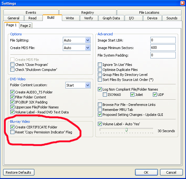

    Just to confirm, I have burned AVCHD to a DVDRW from an image file and it did play back correctly on a PC. When I tried burning the same content direct from a root folder Imgburn insisted on formatting the DVDRW first. Since this can take a long time I created an image file instead.
    EDIT: This is odd? tsMuxeR didn't create a 'Certificates' folder and I didn't add one to Imgburn but after the disc was burned a Certificates folder appeared on the disc anyway!

  22. Member Cornucopia's Avatar
    Originally Posted by ntscuser
    ...EDIT: This is odd? tsMuxeR didn't create a 'Certificates' folder and I didn't add one to Imgburn but after the disc was burned a Certificates folder appeared on the disc anyway!
    Maybe you were missing this in the ImgBurn settings:
  23. The only downside with mkv players will be the no menus i suppose....
  24. Member ntscuser's Avatar
    Mar 2003
    Or indeed this:
