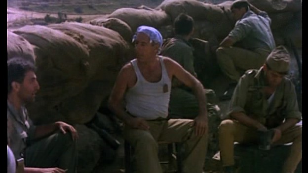

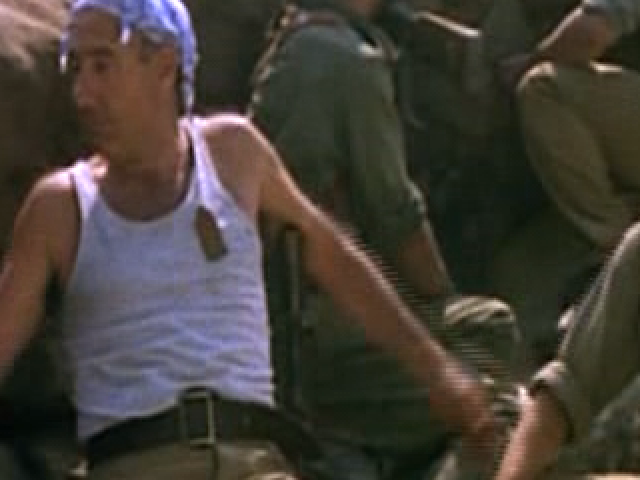

The 4:3 to 16:9 conversion (http://www.mediafire.com/?z5wjujjyimm) had a lot of interlacing and blending artifacts. 2x nearest neighbor crop/enlargement:

Yeah, it was IVTC'd when it should have been unblended with RePAL or SRestore.

For that source, none of them. IVTC is the wrong thing to do when the source is blended. Can't you tell how jerky it plays during movement? It's missing a frame every second, the result of IVTCing to 23.976fps, where the real framerate is 24.975fps. Although TIVTC can "IVTC" to 24.975, it can't do anything about the blending except to make it worse.Which case should be mine?

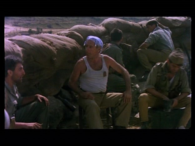

Also, I question the cropping and resizing you did with that source while converting it to 16:9. Your way cropped 10 extra rows of pixels into both the top and bottom of the active video, and left the big bars on the left and right sides. Then it was resized strangely with a resulting bad aspect ratio. I'm not quite sure where you got that crop/resize, but it doesn't seem to have been from FitCD. I'd do it this way:
Crop(18,56,-14,-56)
Lanczos4Resize(688,480)
AddBorders(16,0,16,0)
That uses ITU resizing. -

You are wrong. I didn't do any cropping. I am a film producer and film director, and I abhor when TV or DVDs are re-framed to fit the screen or any other reason. What you see is the size that was on the film. That I wouldn't allow Procoder or any program to do. My main mistake in those days when that film was authored is that I didn't do it for 16:9 as I should have, and did a letterboxed 4:3. That was my fault, because until recently I viewed everything on a 32" CRT screen and I could only watch 4:3. The letterbox at least preserved the original ratio. But the ratio was not changed.Also, I question the cropping and resizing you did with that source while converting it to 16:9. Your way cropped 10 extra rows of pixels into both the top and bottom of the active video, and left the big bars on the left and right sides. Then it was resized strangely with a resulting bad aspect ratio. I'm not quite sure where you got that crop/resize, but it doesn't seem to have been from FitCD.
The sizing you see now, which can be changed, came like this. I use Media Info or Gspot to tell me the original size, but in this case they show me a 720:480 ratio, which I don't think it's the film's. Do you?
