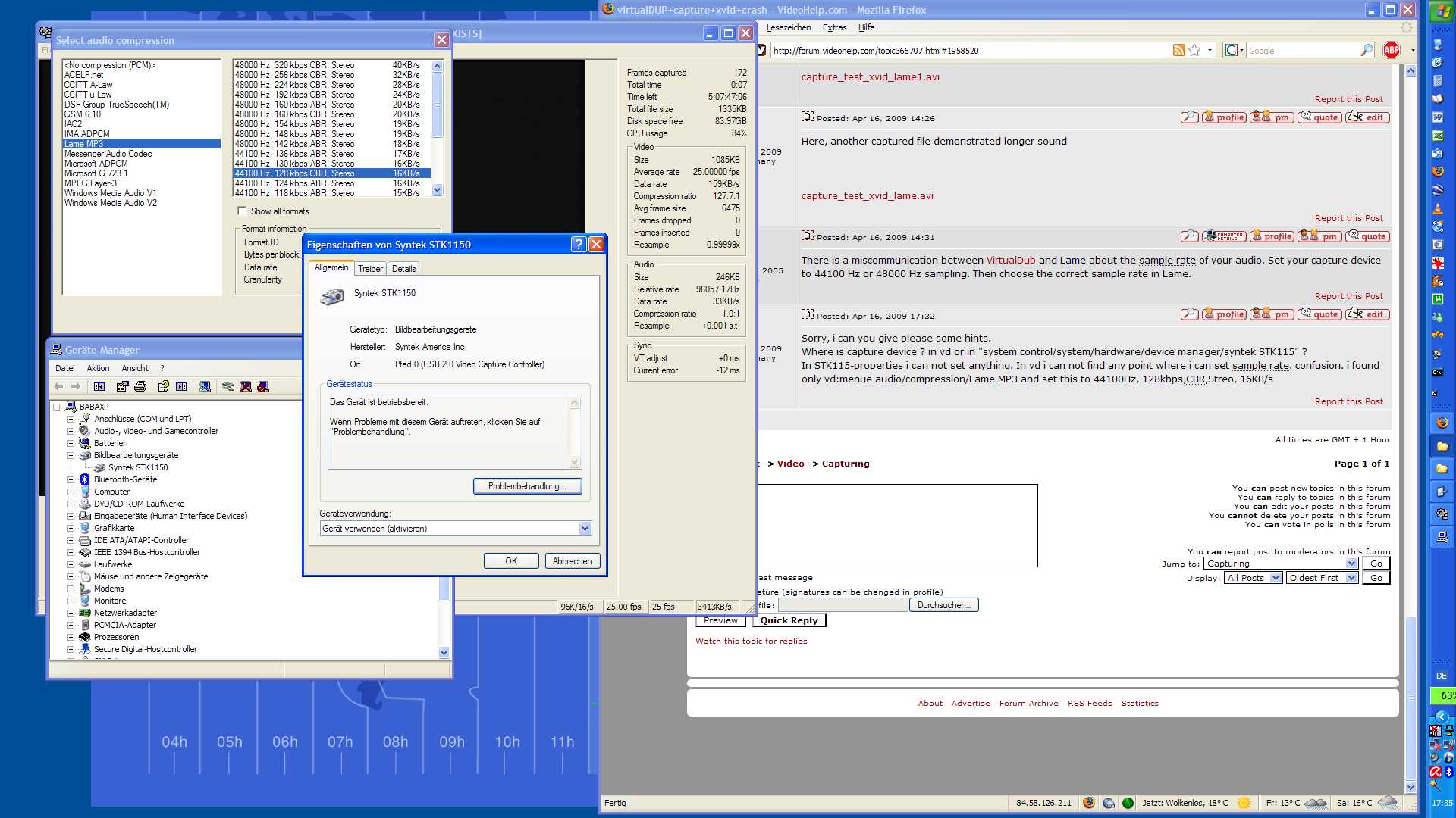

There is a miscommunication between VirtualDub and Lame about the sample rate of your audio. Set your capture device to 44100 Hz or 48000 Hz sampling. Then choose the correct sample rate in Lame.
Sorry, i can you give please some hints.
Where is capture device ? in vd or in "system control/system/hardware/device manager/syntek STK115" ?
In STK115-properties i can not set anything. In vd i can not find any point where i can set sample rate. confusion. i found only vd:menue audio/compression/Lame MP3 and set this to 44100Hz, 128kbps,CBR,Streo, 16KB/s -
i think, it works
my settings:
xvid: interlaced encoding, real-time, resolution: 720x576xYUY2
divx: resolution: 720x576xYUY2
raw audio format: PCM: 44100Hz,stereo, 16-bit (sound is OK)
lame: 44100Hz, 128kbps, CBR, Stereo, 16KB/s
@jagabo: thank you very much for your helping
the sound was ok again after i changed "raw audio format"
can you please acknowledge whether it was proper changing at the right point.
i want unterstand it -
Yes, that is the correct setting to change. Use 48000 if you want compatibility with DVD.Originally Posted by sabo0403
