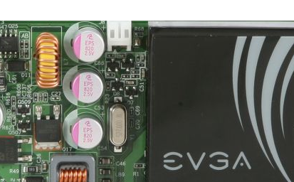

    I put an EVGA 9400 in an HTPC case a couple of days ago. Came with low profile brackets, was a snap to assemple. The TV output is a dream!!!!!! I expected it to look better than my FX5500's and 6200 series cards, but the image quality even blows my 7600 and 7200 cards out of the water. Well worth the $30 (after $20 MIR).

    Sounds interesting, especially for such a modest price point. What about the temps -- I'm thinking this could be an issue for this box, since mine does not have the best airflow design or fan solution -- and doesn't it require a power connection to the PSU ?

    Mine did not. There is a plug, but I don't believe it's for power. Here's the link http://www.evga.com/products/moreInfo.asp?pn=512-P3-N947-LR there are 3 different models, this is the Low Profile model. There is a fan on it, but I did not add any more noise - at least we couldn't tell Other vendors do make both the 8400 and 9400 low profile and fanless. Both of which offer hardware decoding of video formats (MPEG2/WMV/VC-1/h264). The 9400 has a bit more power on the openGL side. Which is what we needed.
    This is in an Antec case ( http://www.newegg.com/Product/Product.aspx?Item=N82E16811129039 ). We also have this one ( http://www.newegg.com/Product/Product.aspx?Item=N82E16811129034 ) which is MUCH larger, and nicer too Looks right at home on the entertainment center.
