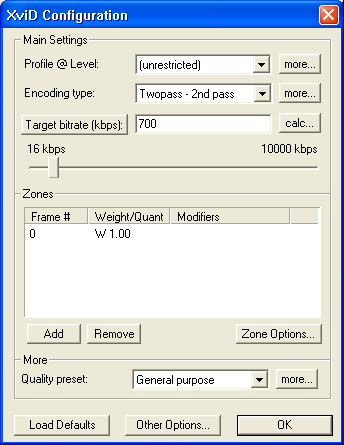

Thanks Jagabo for a quick reply. I was hoping it was possible to do this.
But looking at the Xvid compression config window in virtual dub it looks a little daunting for a newbie.
Where and how do I set the output to be the same size as the input ? -

Use a tool like GSpot to find the bitrate in the original file. Use the same bitrate when encoding and you should get output pretty close in size. There will always be some small variation, but it should be very close to the original file's size. You are hung up in trying to find a size option when what you need to do is set the bitrate for the encode to use the same bitrate as the original.
Note that even with using filters, I'm not optimistic that your final output will be just as good as the original and it may actually look worse to you to re-encode at the same bitrate. Whether you care or can notice this is a good question, but just be aware that re-encoding usually leads to worse quality output unless you use a higher bitrate than the original file. -
Basic Xvid compression isn't that hard.
If you don't care about the exact file size choose press the Load Defaults button (most of the defaults are pretty fine for most material), then select Single Pass, Target Quantizer = 3. Going from Xvid to Xvid that usually won't change the file size too much.
If you really care about file size deterimine what bitrate you want (VirtualDub can tell you the bitrate of your source with File -> File Information) then in Xvid press Load Defaults and select Twopass - 1st Pass. Save as AVI (the file produced by this will be empty but Xvid is also creating another file with information about each frame of the video). Then go back and select Twopass - 2nd Pass, set the Target Bitrate, then save as AVI again.
If you have a multicore CPU you should set the number of threads by pressing the Other Options button at the bottom of the dialog and setting the Number Of Threads. -
