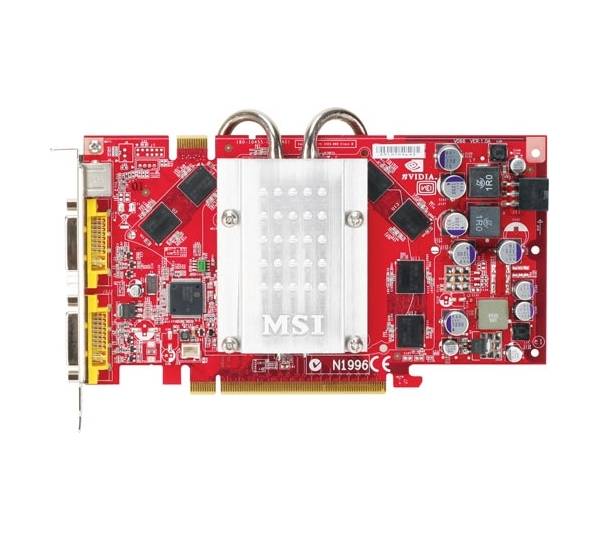

The strange thing is that if you look at the videocard photo, you can see that where the videoram is, that is not covered by the heatsink, as if it is not important ?
Or am I wrong in thinking the videram are those 6 chips around the heatsink ?

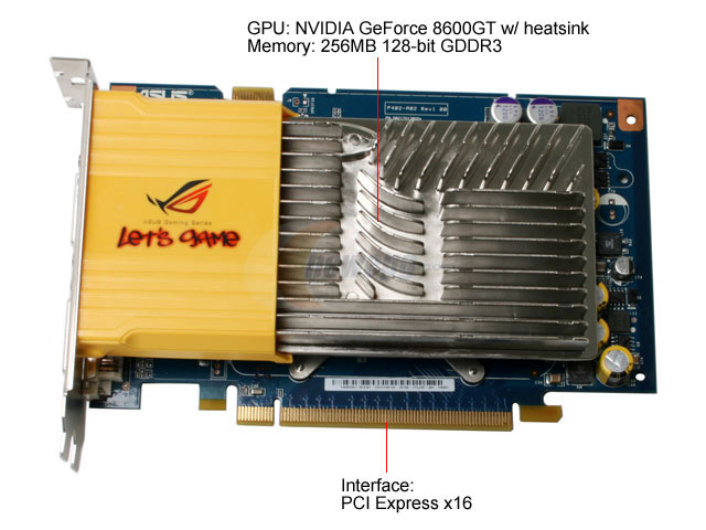

Here's the fanless card I have, an ASUS EN8600GT SILENT (image courtesy of NewEgg):
