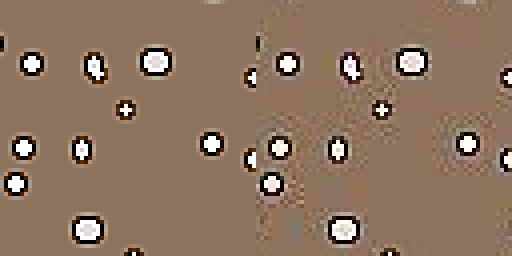

I think the DCT ringing noise in the OP's video is normal for DV compression given the nature of the video. I made an image of whitish spots with oversharpening dark halos on a similar flat tan background then encoded with Cidocida. Here are crops from the original image (left) and the DV compressed AVI (right) enlarge 4x with a nearest neighbor filter:
The ringing noise is very similar to that found in the OPs video:
