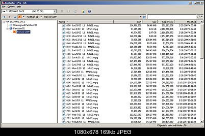

    I just got a Pioneer DVR-630HS last week.
    Its one of the more difficult compact designs to remove the hard drive from, but not too difficult.

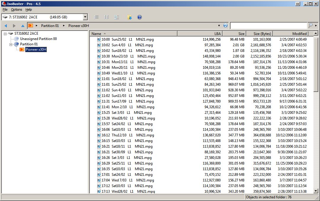

    I connected it to my Windows 7 PC with an IDE to USB3.0 adapter and started up IsoBuster 4.5 Pro
    The attached photo is what it could see.
    The drive is identified as belonging to the Pioneer "x30" family.
    The recordings are listed by their Title name.
    The recordings extract and copy to the PC hard drive complete and playback in VLC or VideoRedo.
    I could edit and then burn them to a DVD or Blu-ray from VideoRedo, but I choose not to.
    That sort of media is becoming more rare these days and I reserve what I have for special occasions.

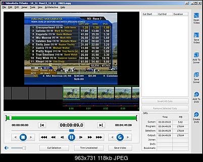

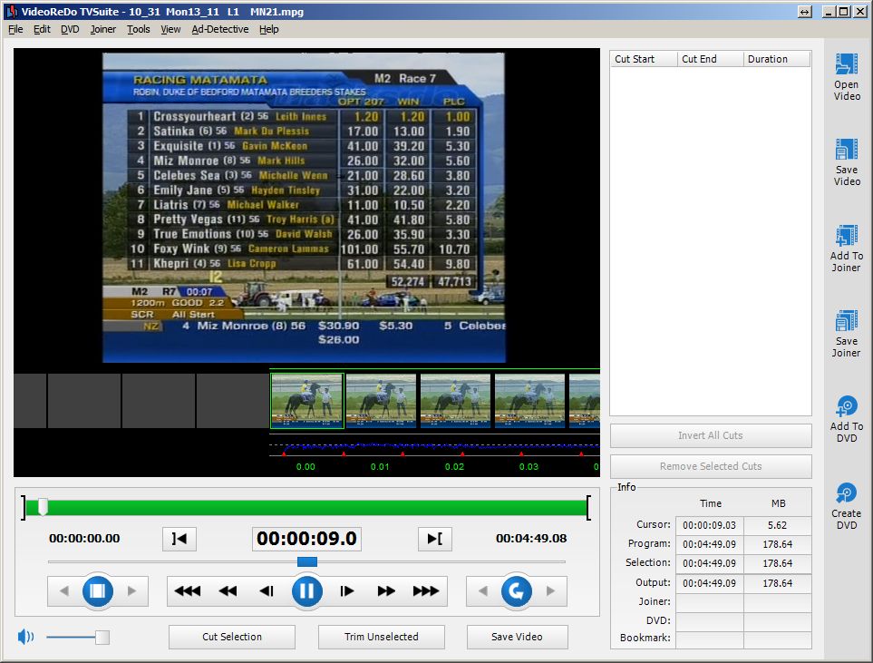

    The second photo is of an extracted recording auto-opened in VideoRedo.
    The recording is from New Zealand in PAL-B format, but that doesn't matter once its in the digital MPEG2 format.
    .. if you don't want to take the time to extract the recordings one at a time,
    Isobuster 4.5 Pro can extract multi-selections of recordings, or all of them at one time..
    or you can simply backup the entire DVR-630HS drive to a single drive image computer file and go through it later
    IsoBuster 4.5 can read the backup image as if it were the real thing.
    That way you can put the DVR-630HS hard drive back in the recorder and keep using it,
    and refer to the backup image later when you have more time to perform the extractions.
