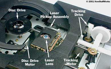

Lastly, some burners don't read all brands of burned media as well as other brands. But I assume these discs are ones the burner could read in the past. This all points to a problem with the burner itself. If all else fails and you have just been using a cleaning disc, take the burner apart and do a more through cleaning. And check the slides for the laser mechanism. The lube may have dried out and they may be sticking.
This is from a CD burner, but the mechanism is similar:
