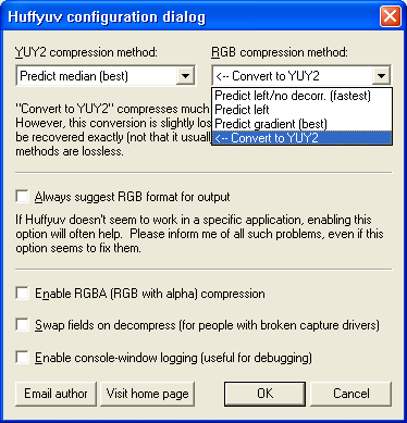

 One thing I haven't tried yet is exporting the Huffyuv file from Premiere in its native YUV format, not RGB as recommend by some Premiere users. So the Huffyuv codec would do the colorspace conversion, rather than Avisynth. Or perhaps that makes no difference? I think I'll try it anyway....

	Well I've solved it - not sure why but it works.
 Exporting my Huffyuv file as YUV from Premiere instead of RGB now gives me Xvid encodes with identical brightness to the source. Color is still a bit reduced but is easily fixed with a small colour adjustment on any television.
 Thanks guys for the help anyway - at least I'm a little wiser about colorspace conversion in general than I was!
	My Huff file was originally being exported from Premiere in RGB mode - as recommended by some Premiere users. So I tried the other way instead, and the resulting YUV file gave me a better looking Huff-to-Xvid conversion.Originally Posted by jagabo
