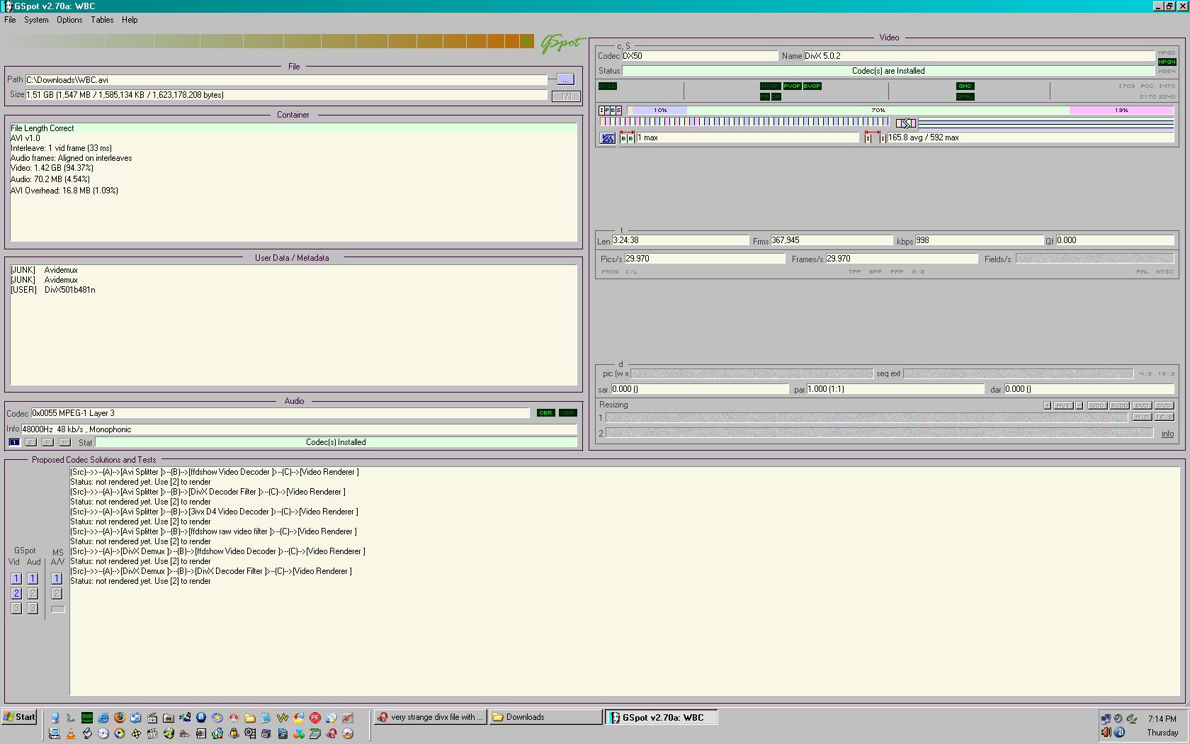

    Post a screenshot of the GSpot window with the video loaded. I suspect the video's corrupt. GSpot should probably be able to tell, as well (it may mention it in one of the top left panes).
    Dec 2007
    Here's a screenshot. I didn't use the render function at the bottom because it crashes Gspot. 512x808802378 is the reported size in Media Player Classic and will open the file. But it will not play because of the ridiculous vertical size. But if I look at the properties of the file using Explorer, I see 512x384 which is correct.

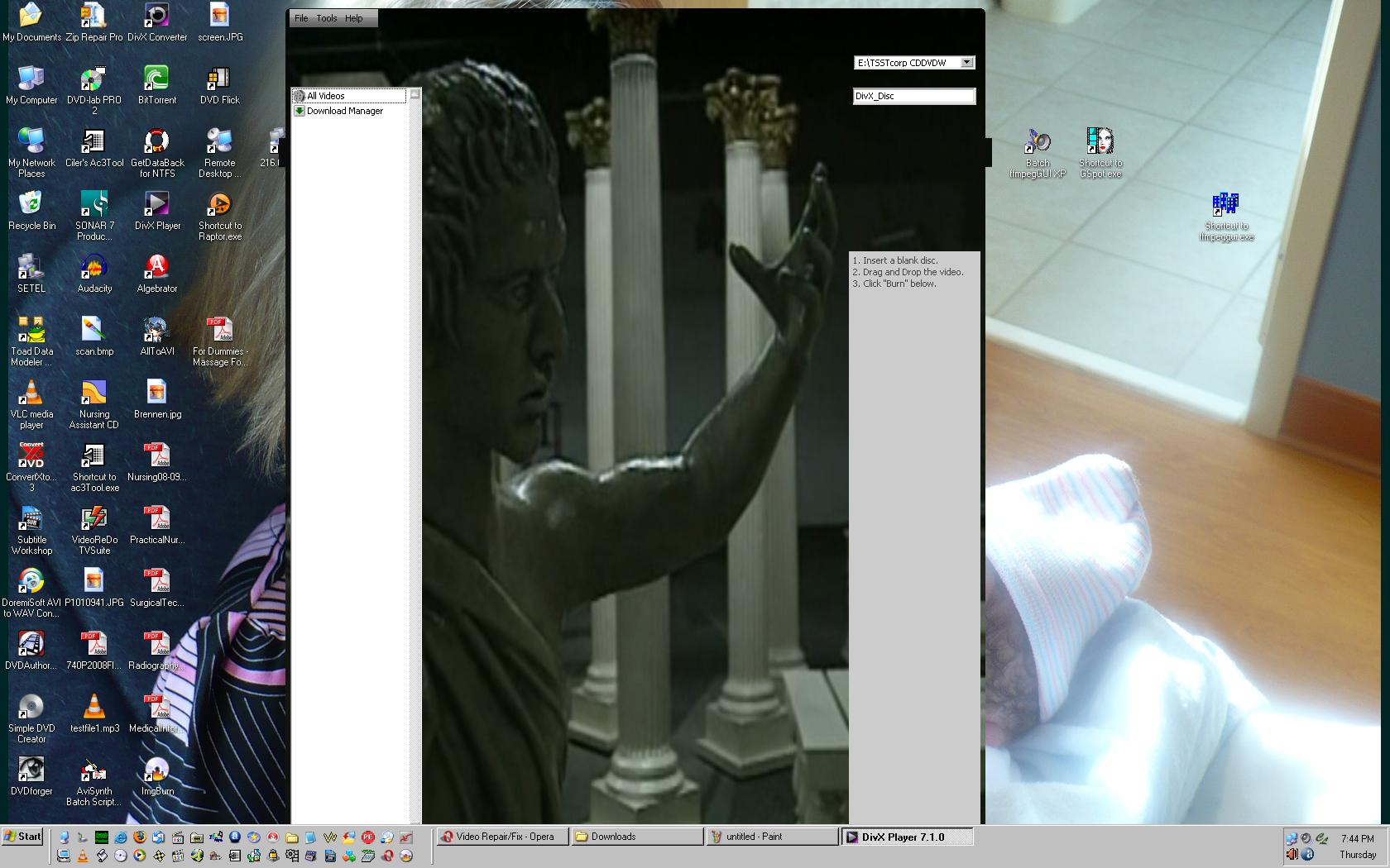

    Heres another screenshot after opening the video using DivxPlayer. Its the only player that will run the file with no problems, except the stupid vertical size runs a mile long. Is there a way to change header info in a avi file?

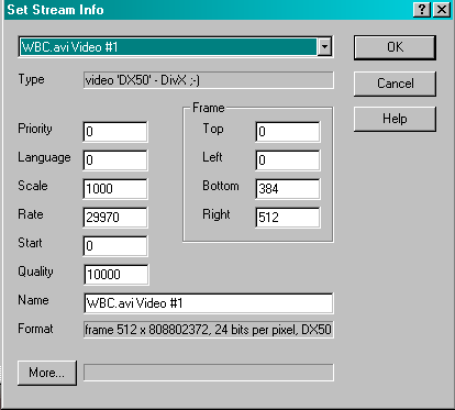

    I have tinkered with hex editors but dont know much practically. I just used aviedit to look at the headers and it says the correct video size. But it also shows the wrong size as well. Strange.
    Dec 2007
    Here's a shot using Aviedit to show what I mean.

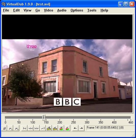

    Even with the wrong value you may be able to open the file and get a hint about what the right size is. For example, I changed my 288 line file to 384 and opened it with VirtualDub. This is what I saw:
    The black bar at the top is 96 lines. 384 - 96 = 288, which we know is the correct size.
