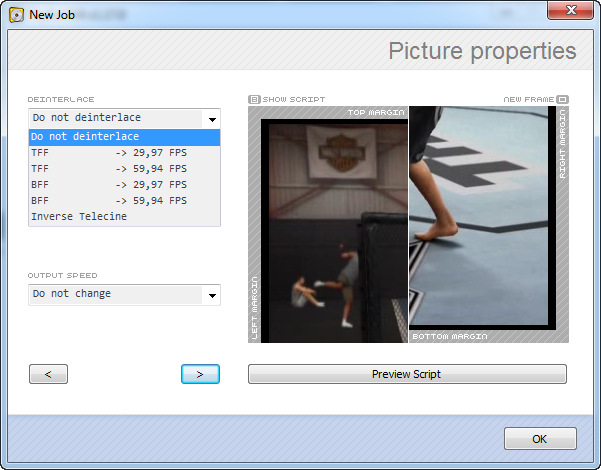

  10. Originally Posted by buddycat View Post
    The clips I have are just stuff I created from VHS conversions or rips from home DVDs.
    Keep in mind they are probably interlaced and need to be treated as such.
  11. Lone soldier Cauptain's Avatar
    Jan 2006
    Brazil
    Jagabo is correct.
    In RIPBOT264 go to properties/deinterlace.
