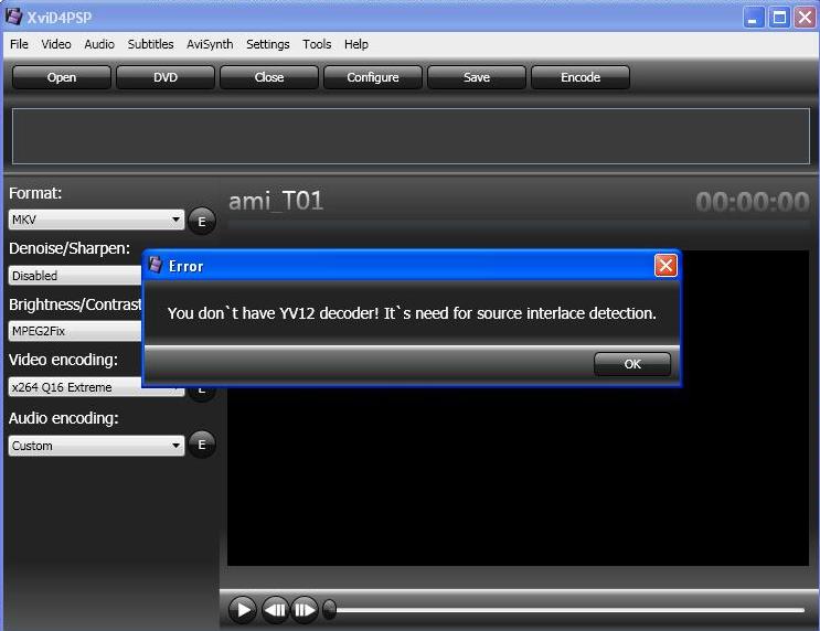

    well i installed Xvid4PSP in one of my friends system and i am getting the error (attached)
    can anyone suggest what is the problem
    Jun 2008
    India
    thanks mystice...the problem is solved
