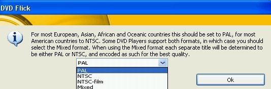

  1. I use DVDFlick to turn avi into DVD and I notice a slight pause about every 1 second that is most noticeable during camera pan or when credits roll. The problem can be seen on several different standalone DVD players that I tried and also when the DVD is played on the computer. My question: is this a problem with DVD Flick, or just the inability of the DVD players and computer to process pan motion video?

  4. Well, I don't have any AVI's at this time, but with DVDFlick, to make your DVD, you must choose between Pal, NTSC, NTSC film or Mixed. There isn't any option for "pulldown". For example, I can see if my source is 25fps, then I should choose Pal. But if the source is 23.976fps or 24fps, or 29.976fps, should I choose NTSC or NTSC film or Mixed?

    1) DVD Flick output to Pal and noticed 1 second jerking
    2) DVD Flick output to Ntsc and did not notice 1 second jerking.
    I am now thinking that DVD Flick is at fault. Should I try something like ConvertXtoDVD? Or should I just leave output as Ntsc and let Standalone and /or TV do the converting? Goal is to eliminate this 1 second jerking when playing on my TV.
